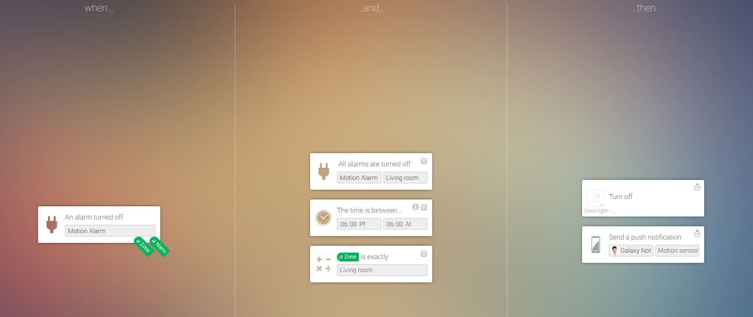

Change flow 1 and 2 to trigger on “devices” card, with the option "an alarm turned on /off, with the value “motion sensor”.
then add in the AND column a logic card to check the trigger card’s zone (which is a tag) = kitchen and for the motion off also if all motion sensors are off (also “devices” card), then you even can add a 3th or 4th etc motion sensor as long as you place it is the zone “kitchen”.

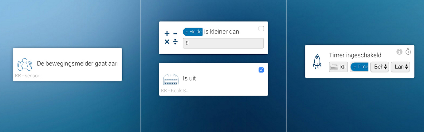

Sorry I’m still struggling. It still shuts down a lot. Is this correct? No use of countdown.
PNG
well, you give your own answer, use a countdown app if you want an extended periode
I cant read it but I presume the switch in the “timer” is the same as the switch in the “AND” column?
Remove that one! It already in the “timer” app functionlaity.
I suspect your problem is the switch never turns on at motion? (That is caused by this “AND”, if it is off, the timer will never be triggered)

Luminance 8 is pretty low, does it reach that level?
(My light trigger ON at 22, I had to increase the OFF level otherwise they would go off right away)
Can’t see the detail of yout timer but it your flow is exactly the same as mine, which works flowless.
