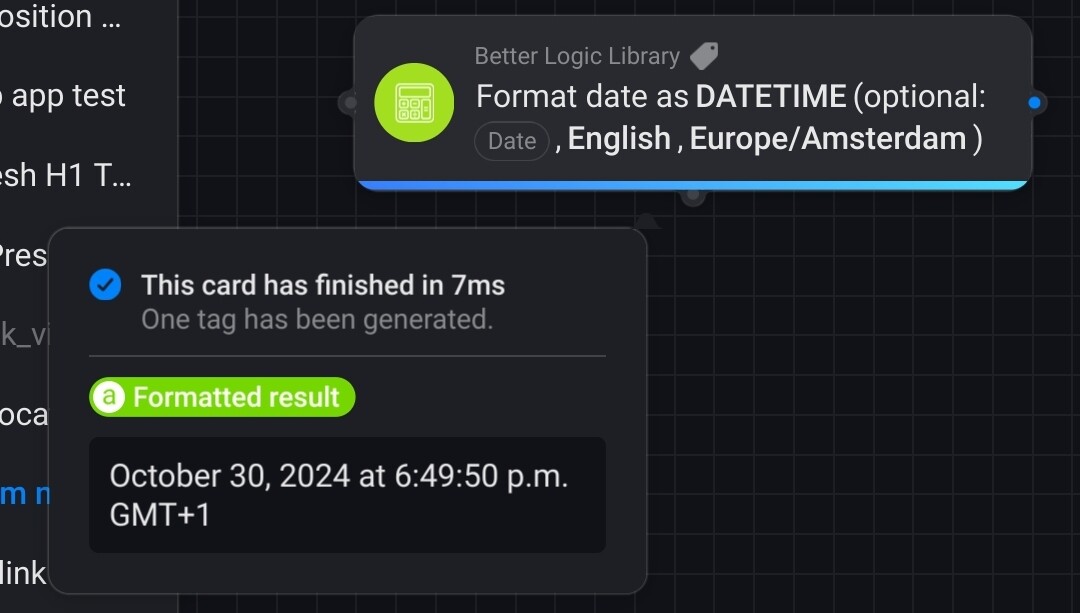

Hi Eko,
I’m afraid this topic is about app developing.
Users can use this BLL card as well:
Thanks, as so any times earlier, a lot is avail, but so hard to find :slight_smile:
