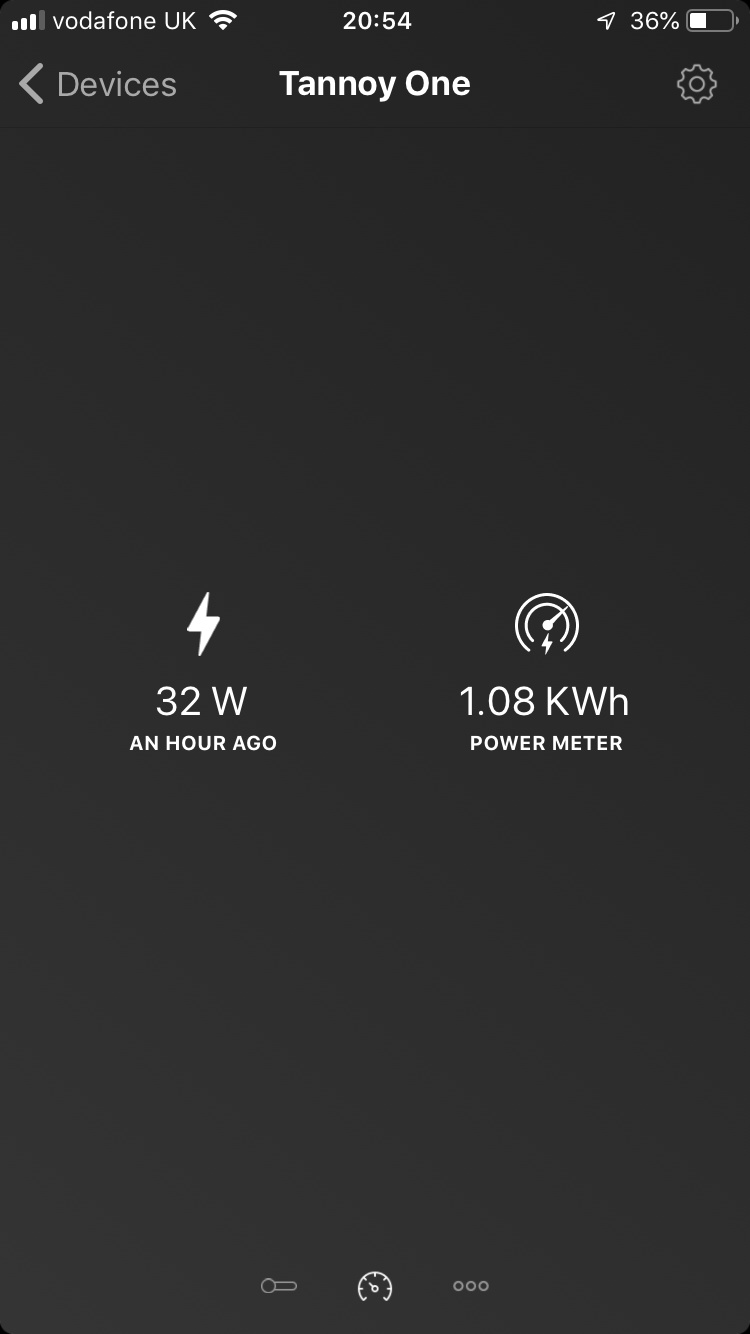

Thanks! I’ve edited out those codes. One question - when you run your app on your system, does it automatically update the status (power on/power off) of devices and the energy meter to trigger flows, etc?
It doesn’t on mine - Just trying to work out whether that’s something that I still need to get to work or if its just a case of this being a feature that hasn’t been coded yet and I need to be patient
Interesting that the Home / Away has a product code and that’s the one I thought might be causing the problem. However, there is a device that’s not returning a product code so I think that might be your missing 3 gang dimmer. I’m not sure why the format is different for that. I did notice it had an “upgrade”: “yes” so maybe it needs to have the firmware updated.
It should request an update when first connecting and then gets updates via a webhook after that. I use a flow that picks up a dimmer being switched off and switches off a z-wave light. I must admit I don’t think I tested the flows using the energy meter so I will test that soon.
You could try restarting the app now you have devices add just in case my changes have broken the web hook initialisation at inclusion.
Good spot re the firmware upgrade! I’ve done this now, much to my wife’s dismay as the lights started flashing while she was cooking
Still no luck with the three gang dimmer or updating status though; even after a restart of the app; I think I’m missing some of the functionality that you have in that if I switch on or off a dimmer, say via the Lightwave app, Homey doesn’t ‘see’ that that is has happened. Good to know that this is possible, though; hopefully an easy fix.
