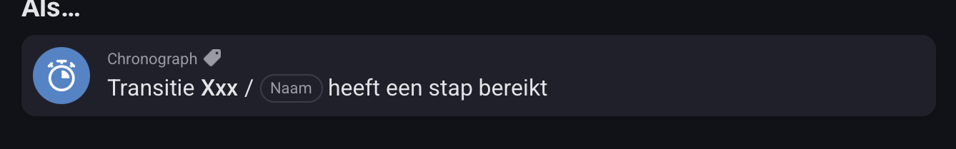

With the. Chronograph-app you can create a transition:
This gives you a trigger:
Now you can dim to the transition-value. Each step the transition-value lowers from 1 to 0,5 with 0.5/20 per step.
