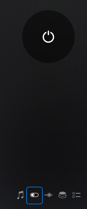

You don’t get this if you long-click the device?

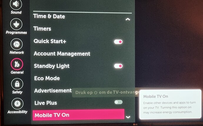

If you’re able to turn it off (with the Homey LG app), when it’s on, you have to dig into your TV energy settings. Due to energy saving stuff, it doesn’t listen to network commands when it’s off/standby.
When you find something like “turn the tv on with the mobile app”, enable it.

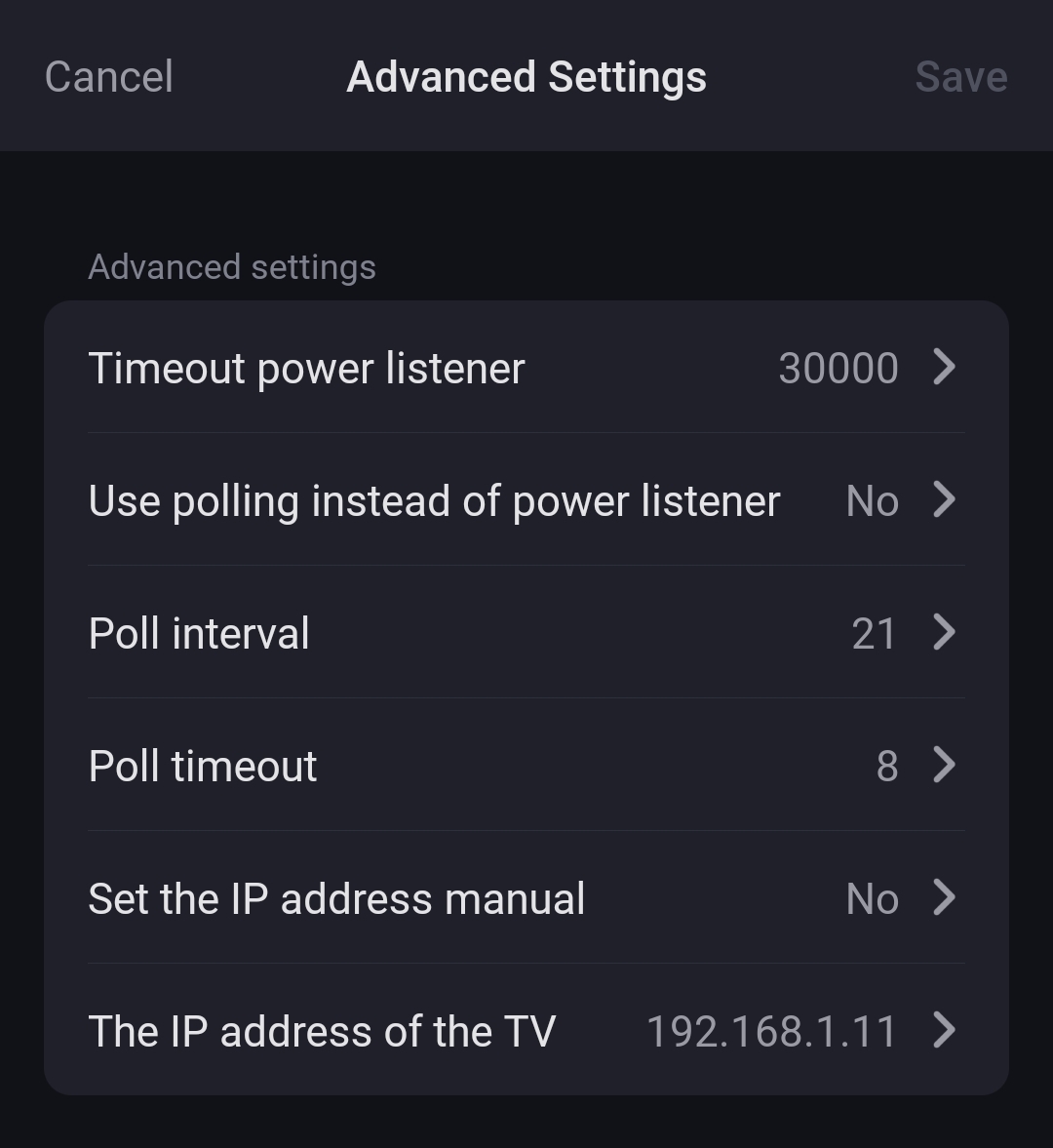

One other possibility, your LG got an other IP address, so Homey possibly can’t find it (looking up IP adresses is not Homey’s best skill).
Check the DHCP table in your (probably) router, or use Android Fing or Ning to discover it’s IP.
Make sure to reserve IP adresses for both Homey and the TV, so they always get same IP.
To compare, these are my settings, works great for almost 4 years now:
