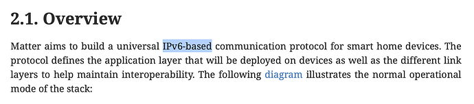

Matter depends on IPv6, which both Zigbee and Z-Wave do not and will not ever support :man_shrugging:t3:
Yeah, might be, but Chatgpt said “…”
Exactly the confusion sigh
Matter does not.. its Thread that depends on IPV6
Matter is the Application Layer, not the network :zipper_mouth_face:

You should tell that to the person who wrote the Matter specification:
