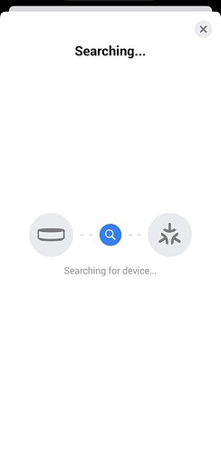

Hi everyone, I’m having an issue with an new IKEA Matter device.
I have a self-hosted Docker setup running on a Synology NAS, with a Thread border router via an Apple TV connected to the same network.
When I try to add a device, the setup goes smoothly until the naming step. Then, the screen stays stuck for about 10 minutes before timing out.
I’ve tried 4 or 5 times, resetting the device each time, but nothing works.
Does anyone have any ideas?

@Waldo Thank you for your reply. Actually, I can’t select that option when adding the device in question. Perhaps this is a limitation of self-hosting?
This is the error I get when trying to connect to the matter device.
(works on Homey Pro, and Homekit, but not on SHS with ipv6 enabled)
