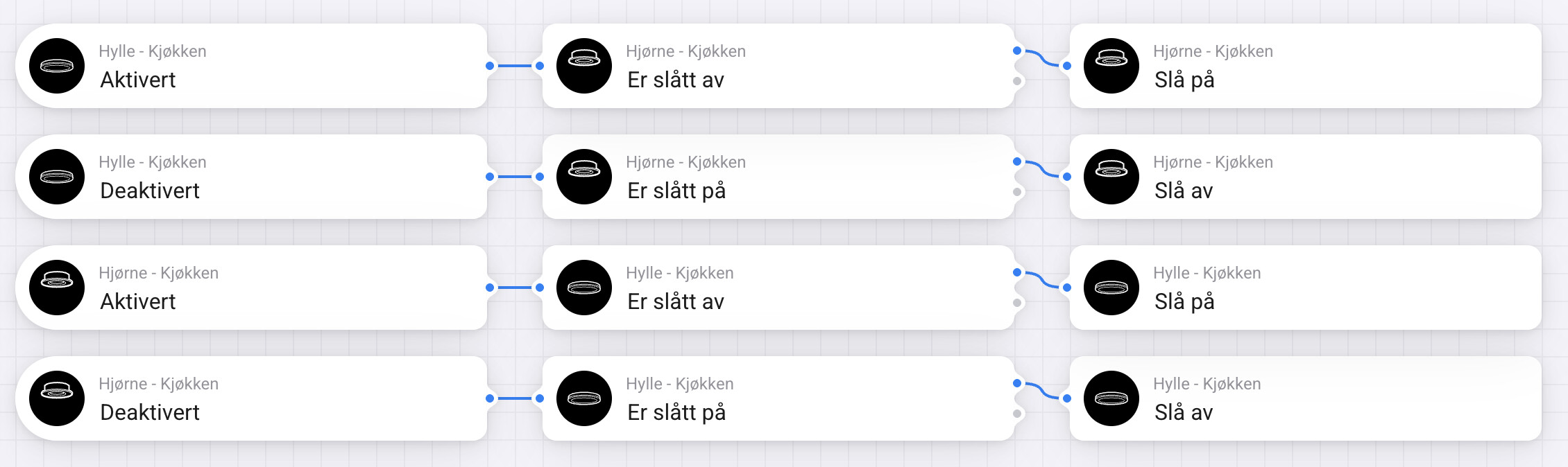

Is there a simpler way of syncing two lights?
I’m thinking there should be a way of saying “if A changed, match B to whatever A is set to” (and the inverse).
(“av” means OFF, “på” means ON)

Using the native homey light grouping didn’t sync the on/off state between the lights. I want both my lights to turn on (or off) if I press any of their physical buttons (like my flow does).
I could make a flow like this, though:
