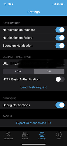

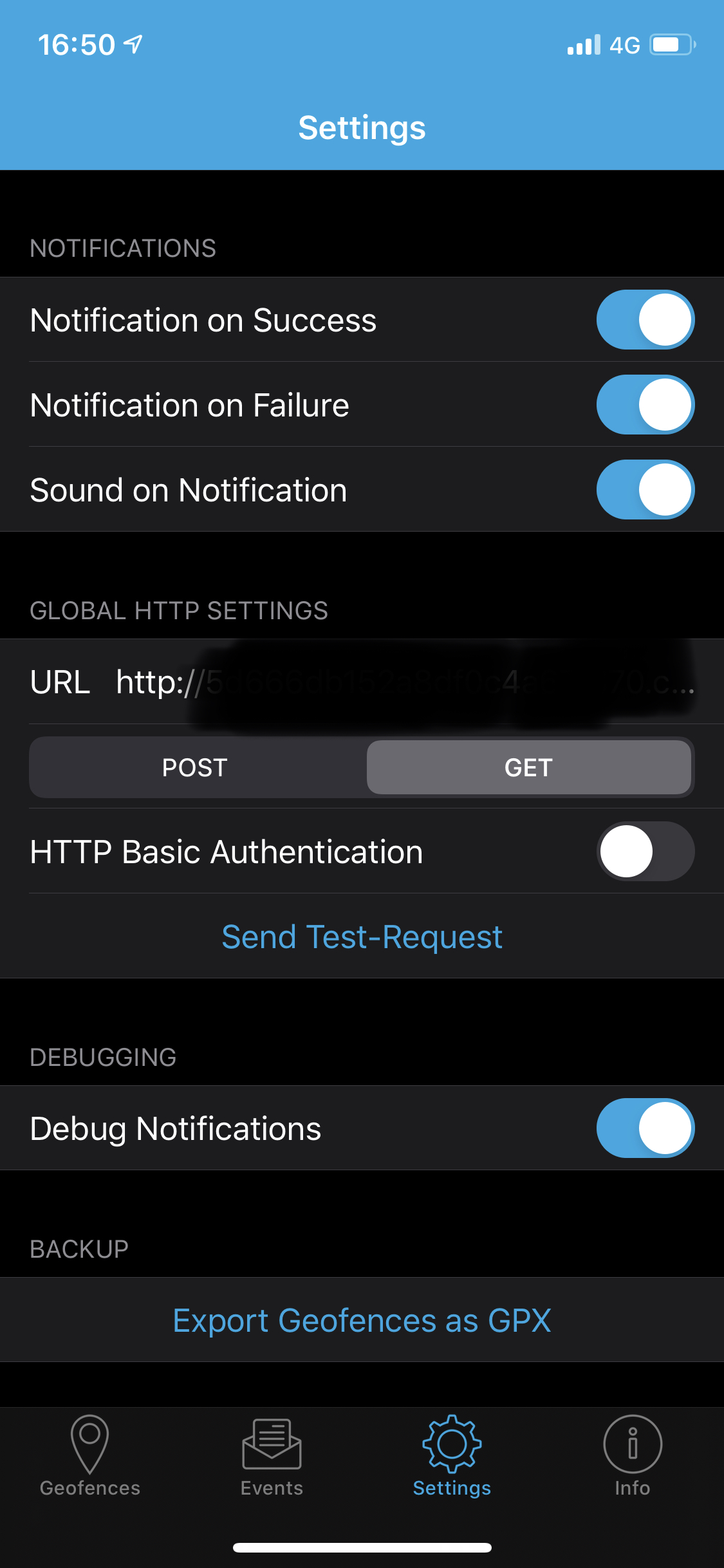

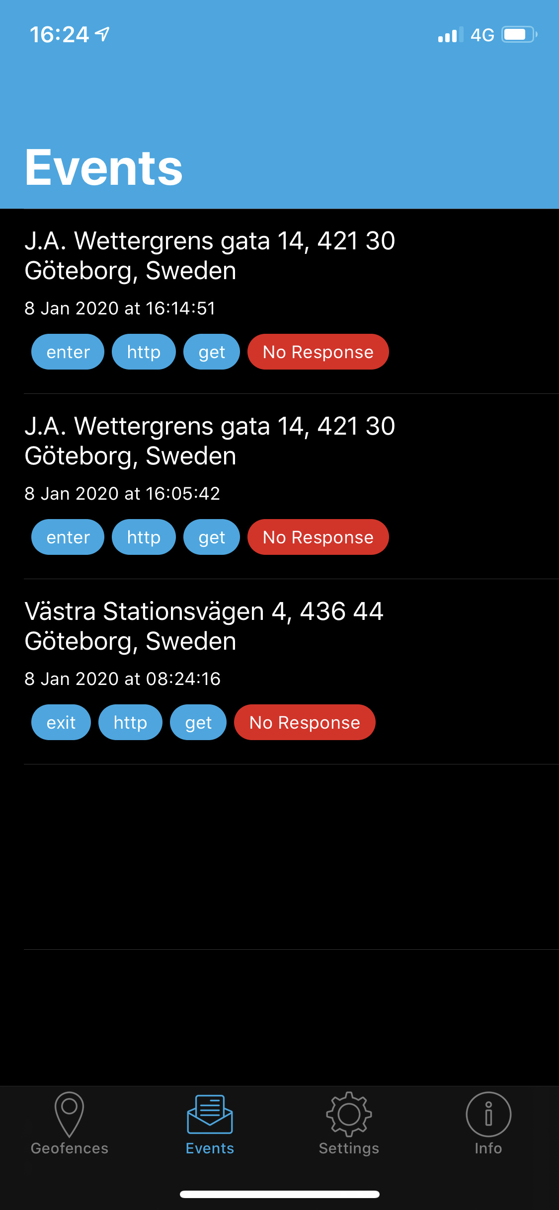

But nothing happens, I have used my cloudid and the string, tried test and it gives me the following see pic
Without giving up ur cloudid could u tell us how the url looks like ?
Or maybe een screenshot from the settings page where u hit the test button?
Of course. Sorry
http://x.connect.athom.com/api/manager/logic/webhook/locative?tag=kommahem
Must be with HTTPS
