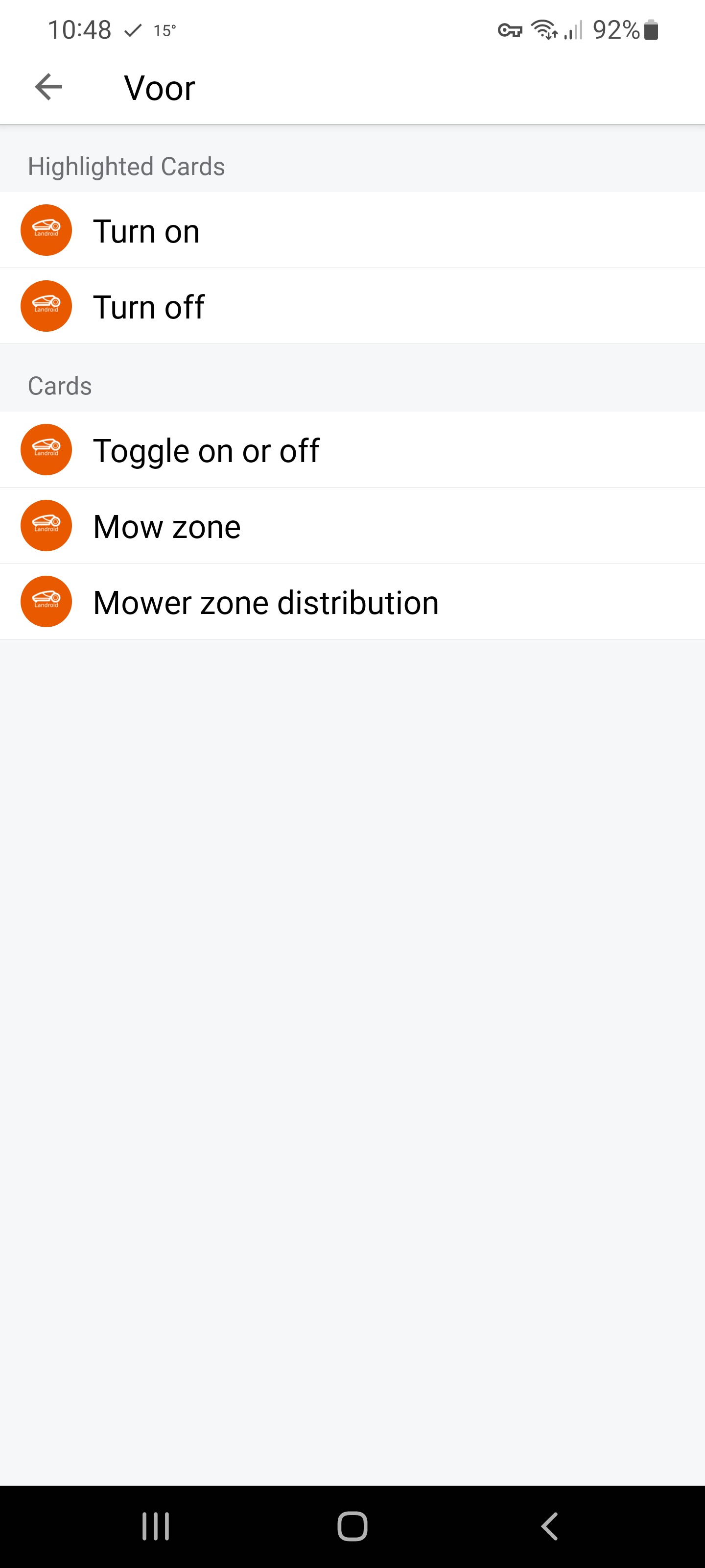

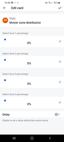

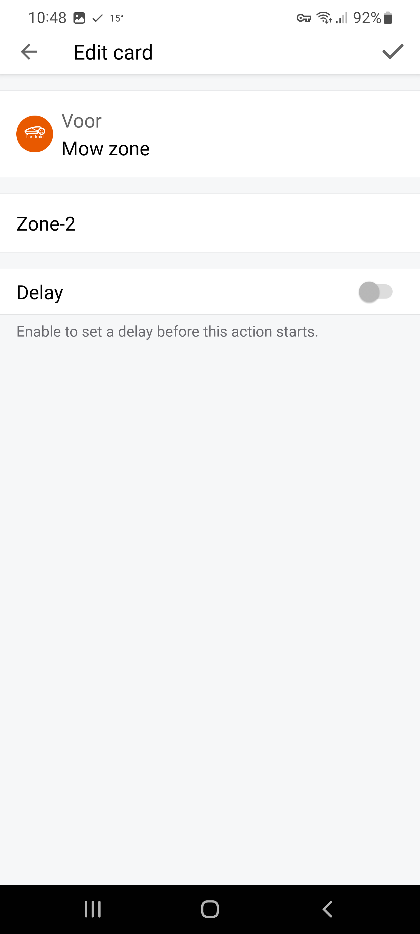

Trying to design a flow that switches the 100 % between my zones I do not manage to find the action card - neither after installing the new versions 2.3.0/2.3.1/2.3.2/3.0 nor after several restarts of the homey. The new trigger cards are there… What am I doing wrong?
when it finds that the mower uses zones it will add the capability and with it the action cards, if your mower is offline, it might not see it as it does not get updates (my 2 cents).
Ah, okay. Most probably I’ll be able to reactivate the mower tonight - and test and report the results.
Thank you! Felix
Hey Martin,
as you assumed: directly after the mower was online again the app got the zones. Designed some flows and for me it works perfectly!

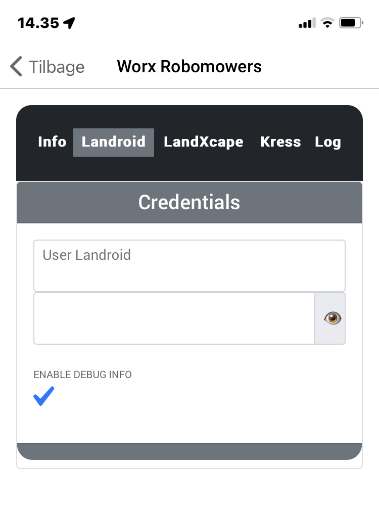

Can not get the app to find landroid , it is on wifi , but it says No new device found hmm.
In the app you type user and password , is that your email and password for your worx account ?
Sorry found the problem in password wrong
