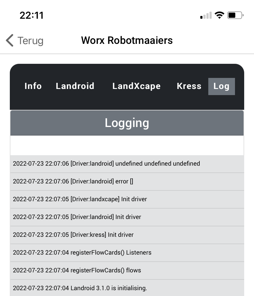

Thank you for the app.I have a landroid WR105SI.1. it looks like this one is not supported ?
Logfile:
Adding the landroid with new hardware it can’t find any landroid.

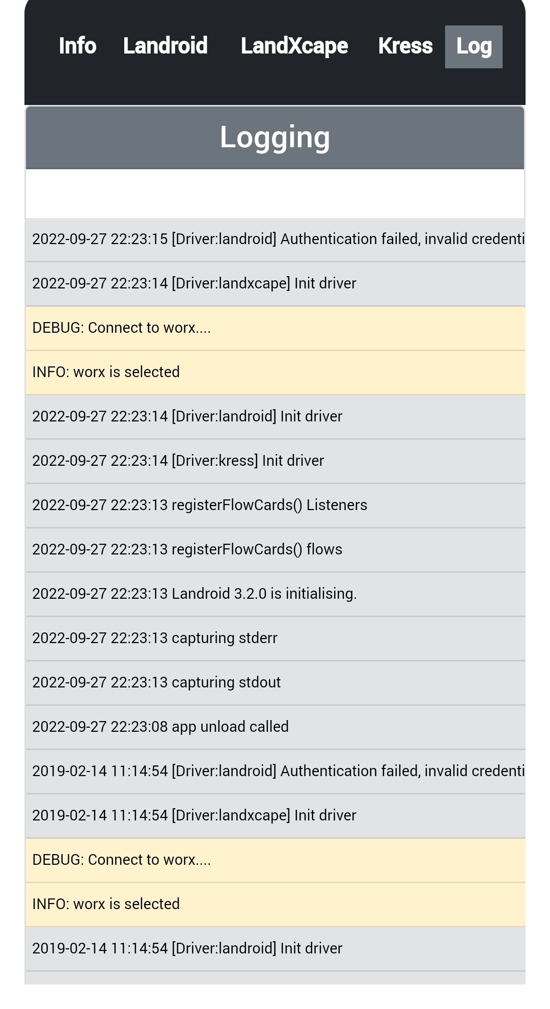

I set the settings for inlog on landroid tab and put the debug mode on. See the picture.
Anything else I can try?
Ofcourse i restarted the landroid and also restarted your app…
Hello Martin,
Problem solved. Password reset and the problem was solved.

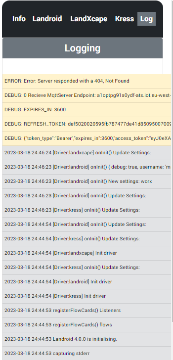

i am trying to integrate my landroid with homey but i keep getting the message that it cannot find a device.
Here are the logs:
What should I do ?
thanks in advance

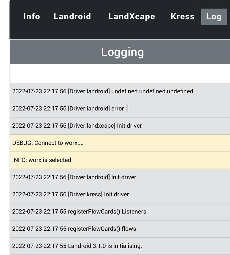

'Morning guys, Martin,
i have the same issue. Credentials are ok, but still can’t find my device, i have a WR310E
Any advice or tips?

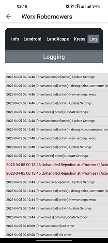

I can’t get the app to find mine wr142e
also having problems being able to add mine to homey nothing comes up… when will it be fixed?
