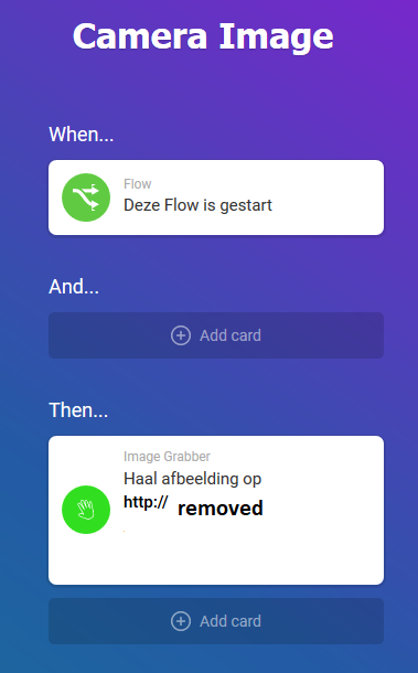

Image grabber is not working, when i put in an URL i see a new image in developmer.athmo.com but the on older image is send. It looks like the image is not overwritten with a new grab. I use the right tag for sending the images ! Can someone help me ?
This has worked in the past but the last months it doesnt any more.!
You must use the “An image has been grabbed” card in the “When” column. Did you do that?
It sounds like you take the “Then” card for “grab an image”, then immediately send the image. This will not work and use the old image.
Ok, that should work. The ‘image’ tag is the ‘local’ image tag from the flow I assume? Then there is nothing wrong with this flow. Might be a bug in Homey then.
