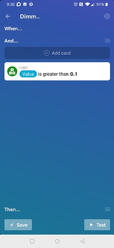

Ill attach my settings. For me it worked fine dimming only one light but the more lights, the buggier. Unfortunately I have 8 lights I want to dim so it’s not exactly perfect. If you want to test the dimmer just to see if it works, create a variable under more>logic>+(number variable and set it to 1) and add it as shown in the screenshot. When turning the knob, the number should change from 0.0 to 1 where 1 is 100%.
If it’s running from 0 to1 why not use greater then 0?
I guess you can, it’s just that, at least for me, the dimmer “bounces” and never really reaches 0 and it often ends up on 0.1. I just assumed that they behaved that way but it might just be mine thats buggy…
