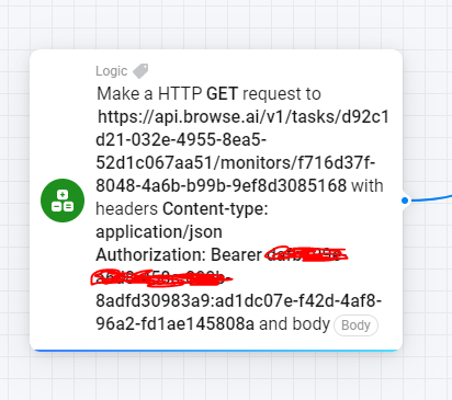

Hey. Hey. I would like to retrieve the current diesel prices in my area from the website. I found that it would probably be possible using www.browse.ai where I can create a robot. Has anyone solved something similar?
This is what I get from browse.ai robot:
I have created an API on the site to call this monitor.
Now comes my problem and how to get these values into Homey :smiley: :smiley:
nafta3
I still can’t get over the error: {ā€œstatusCodeā€:401,ā€œmessageCodeā€:ā€œunauthorizedā€}
I admit I’ve never made any flow that works with HTTP requests, so I’m just getting familiar with it.
Thank you for any help :hugs:
Have you tried the API call over Postman or other tools? You can download the OpenAPI definition and import into Postman. It is working for me, but I tried different endpoint. Then you can compare differences between calls from Postman and Homey.
