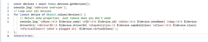

I did get this script from @Peter_Kawa to get al the ID’s
Tried to copy the script, does not work. So i made a screenshot, sorry.
@Mike1233 @Kristina_Bertilsson
This works on my Pro 2019, and it can search for a specific device:
