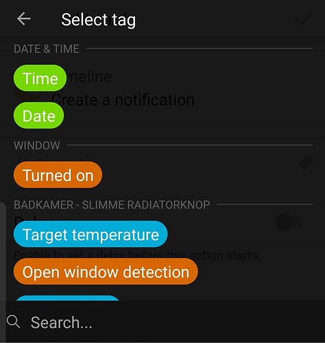

I guess using a 2nd flow would get you your data
If…
-the travelingtime to work was updated
Then…
-create Timeline notification, and now press the tag icon
and with the next screen, enter ‘google’ or ‘work’ in search field
Thanks! Feel like I should be able to solve this in one flow, two flows works fine. Also, for anyone checking out this post regarding google maps, I found this comment to be helpful as well: Google Maps? - #5 by Marcotics
