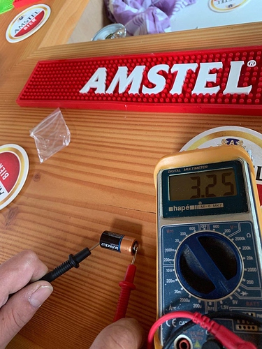

  3. Measure the voltage
    Put the battery down and make sure it is not moving. Hold the black test lead against the negative side and the red test lead against the plus side of the battery. You can now read the measurement on the multimeter.
When f.e. you need to measure a 3V battery you put the multimeter on the 9V battery position (see pic above) and put the 2 pins on the battery where red is the (+) and black will be the (-)
A new 3V battery f.e. should measure more then 3V like 3.22V or something like that.
As you can see in the above pic this new battery is 3.25V.

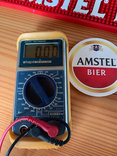

And this is not a new battery in the above pic.
