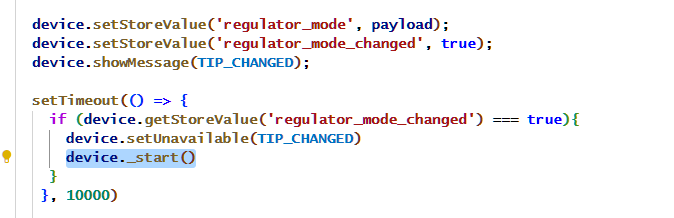

This is CODE block. APP runing, then run the CODE " removeCapability " ,and add other capablility,and THEN to error: “Unavailable” appears at this time
Sorry, i need more code, like in what function is this executed?
This code itself looks correct, i don’t see anything wrong with it.
But the unavailable means a error in the codelines, not a error in adding or removing capabilities itself (if you have no capabilities, it shows an All works perfect screen.
Is the function/method itself async ?
What does the log show? What is the error? which error line?
What do you use to develop? Visual Code?
Please share the output of the Terminal of the last few lines (after trying to execute the code above)

**CHANGE run mode,then call _start() method. **
Where does the “Please go back and WAIT for reinitializaing […]” text comes from? I don’t see it anywhere?
And could you please explain what you want exactly?
Because as far is i can see, you puth the device on Unavailable yourself, but you set it back to Available.
Only, you don’t (a)wait for it?
This might be the issue:
async _restartApp(){
    this.setUnavailable('Device initializing ...')
You dont wait for it to be complete, so it might be that this.SetAvailable is executed while the setUnavailable is not yet done.
So, before doing anything else, i advice you to go through your code again, and make sure that everywhere/in-the-_restartApp, all async methods are (a)waited for:
    await this.setUnavailable('Device initializing ...') ;
Check Device - Homey Apps SDK v3 for methods that have async in front of it:
If all is written correctly, it should work by putting it unavailable and available again:
This works fine.
If it still doesn’t work correct after putting await in front of all methods that are async, let me know.
Thks, i try …
