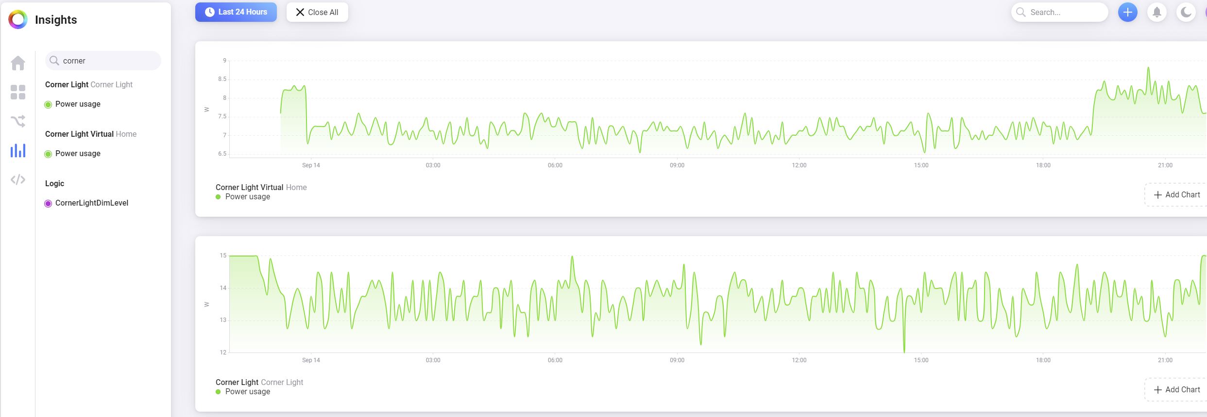

Even stranger things are going on. The bulb was turned off all night, while Homey shows the above power usage. One of them is virtual, representing the other one.
Homey doesn’t think.
The smart socket sends power values to Homey. When it’s disconnected from mains, it simply stops sending power values.
The heater or bulb most probably have a fixed entry for on and off power usage, like this (advanced settings):
So when their status is “on”, even when the power was cut earlier, the energy ‘thing’ keeps counting it as if it was using power.
