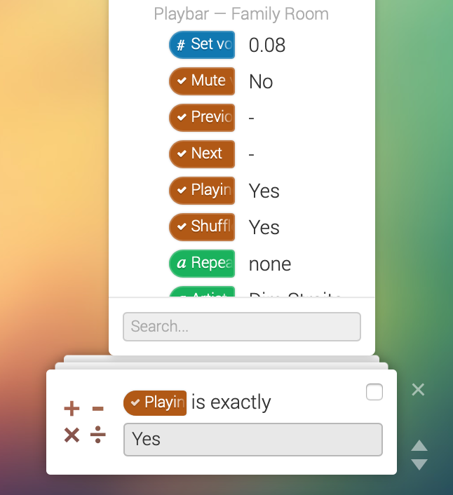

Why not use the ‘Tags’ to set the status ?? Using Logic (or better logic) Some thing like this :
The tags suggested by @anon2681894 will work, if the Sonos is exclusively controlled by Homey…
Please not that if you change the volume through the Sonos app, the Homey tags will become out of sync (show an incorrect state).
U sure about that?
For me the ‘playing’ tag also toggles when using the sonos app, or control the sonos by pressing the fiscal button. So i guess it does not have a sync issue there… :slight_smile:

On the top of ur flow page there is a “Tags” section. Click it and find ur Sonos speaker. There u will find the tag.
Also in the pic @anon2681894 was showing u a few posts up.
