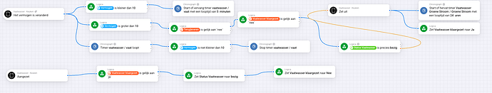

1. Preparing the Appliance
When I load an appliance and it’s ready to start, it automatically powers off, and the status is set to Ready to Start. The flow then waits for the best time to start using solar energy.
Example Flow:
• When: Current power usage changes.
• And: Power usage is above 10 W.
• And: Delivering Back? equals “No.”
• And: Dishwasher Ready to Start equals “No.”
• Then: Turn off the device and set Dishwasher Ready to Start to “Yes.”
2. Starting with Solar Energy
When enough solar energy is available, the flow turns the appliance on, and the status is updated to Busy.
Example Flow:
• When: The appliance is turned on.
• And: Dishwasher Ready to Start equals “Yes.”
• Then: Set the status to Busy and set Dishwasher Ready to Start to “No.”
Problem Solved: I noticed the system kept turning the appliances on and off when backfeeding stopped. Splitting the flows fixed this issue.
3. When the Appliance is Done
When the appliance finishes, the flow detects it by monitoring power usage. After a 5-minute timer (to avoid false positives from power spikes), the status is updated to Full, Clean. A notification is sent, and a task is added to my Todoist to empty the appliance.
Example Flow:
• When: Power usage changes and drops below 10 W.
• Then: Start a 5-minute timer.
• When: The timer ends.
• Then: Set the status to Full, Clean, send a notification, and add a Todoist task to empty the device.
Resetting the Timer
To ensure the timer doesn’t finish prematurely during short power fluctuations, I added a reset mechanism:
Example Flow:
• When: Power usage changes.
• And: Timer is running.
• Then: Stop the timer.
Here i putted the different flow
When Device is turned on
And the Logic Vaatwasser klaargezet eqauls Yes
Then set Status Vaatwasser to Busy
Then set Vaatwasser klaar gezet to No
I found out when i had this as one flow the system was continuesly turning on and of my device when i stopped delevring back to the grid.

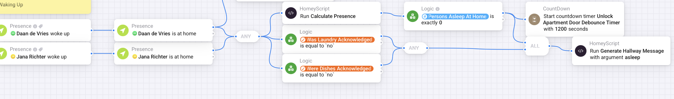

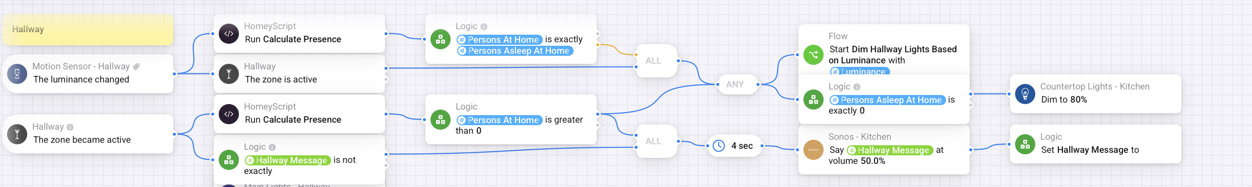

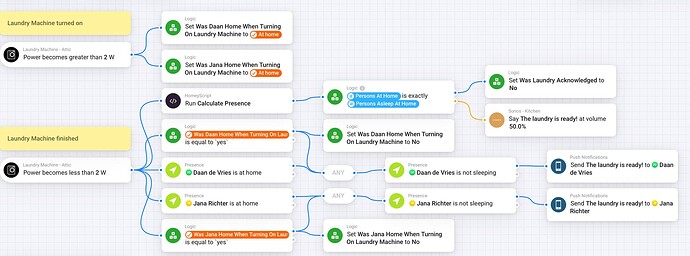

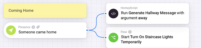

And here are the three flows you need to use it. One for when someone comes home, one for when someone wakes up, and one for when the hallway motion sensor is triggered:

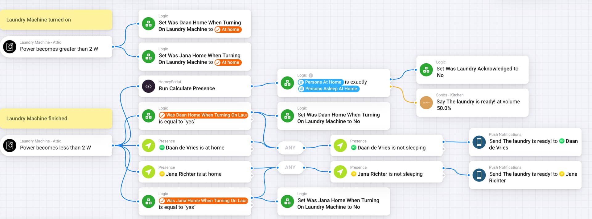

And maybe it’s also nice to share these:

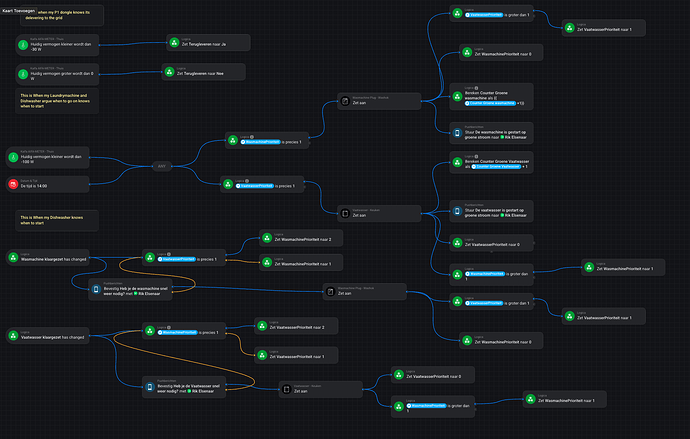

Thats a good one! I thought this was easily done with Advanced flows by this is not yet automatic but i will continue to play with this
As you can see in the part in the bottom i tried to automaticly sort the devices and when they run they go to the next one in line.
I made this work with a Notification, That send the question to the person thats at home, do you need this…? I am looking for a way to intergrate maybe a Dashboard in the rooms with these devices so i can start them from there.
You can see that in the bottom part as well in the picture
The only problem is when you go with enough devices the flow will become very big
