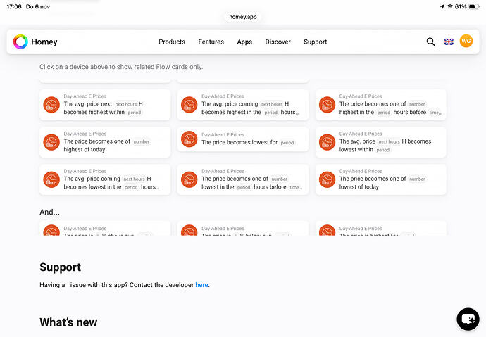

You have to look at the app power by the hour:
Hi @Wilfred_Greven . I have been looking at Power by the Hour, but I just don’t seem to find a card that says “The next hour is one of the x cheapest before <7 AM>”. Do you have a suggestion on how to do it?
See the picture. The card is there, and more…
Please check the PbtH app topic for more Q&A, you’re not the first ‘struggling’ with this

I’ve got a flow that if the water boiler hasn’t been on for 48 hours I want Homey to look up the coming 24 hours and pick the four cheapest consecutive hours and start the boiler.
This one only works for 8 hours or rest of day.
If the 48 hours happens at 23:30 and it won’t help much
In the apps page it shows a card in Swedish that is slightly better perhaps but still faces the same issue.
Rougly translated to The average price for the [duration] period will be lowest between [start time] and [end time].
In the English version this isn’t showing any “between” cards.
I only have before o’clock which means that if the 48 hours happens at 23:30 and I set before 23:59 o’clock it won’t help much.
