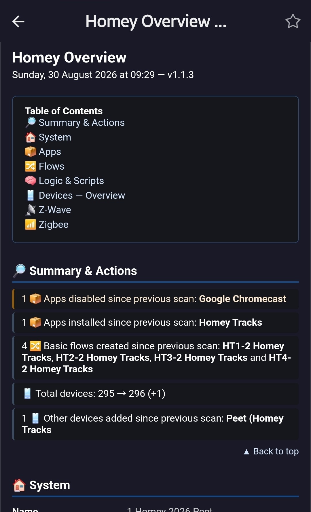

[HomeyScript] Regular system overview by email with a change summary

v1.6: I added WhatsApp-functionality, so you can also receive the summary in WhatsApp.
Very cool again, Dagmar!
With an already configured CallMeBot WhatsApp “device”, the WhatsApp message appeared right away:
v1.7.0 updates:
  • Zigbee nodes that haven’t reported in longer than zigbeeStaleDays (default 3 days) are now flagged in the Summary, same as Z-Wave already did.
  • Low-battery warning (lowBatteryWarningPercent, default 20%), across all device types, excluding EVs.
  • Unexpected Homey restarts are now detected via uptime comparison.
  • The footer now also shows the actual script’s name (“…HomeyScript homey-overview v1.7.0”), read dynamically
Homey Overview v1.7.1 update:
  • Zigbee and Z-Wave devices are now diffed by their stable ID instead of by name, so renaming a device in the Homey app shows up as a single “renamed” entry instead of a confusing remove+add pair.
  • Added diagnostic logging for a rare case where the Storage field showed “-” — no fix yet (cause still unknown), but next occurrence should give more info.
Homey Overview v1.7.2 - update
  • Zigbee “not responding” / Z-Wave “unreachable” tracking could get confused if you renamed a device while it was already stale/unreachable. It would falsely report it as both “recovered” and “newly affected” in the same run. Now tracked by stable ID instead of name, so a rename alone no longer triggers a false pair.
  • Basic and Advanced flows are now also diffed by their stable ID, so renaming a flow is reported as “renamed” instead of a confusing delete+create pair, and if a flow is renamed and becomes broken/disabled in the same run, both changes are now reported separately (previously one could mask the other).
