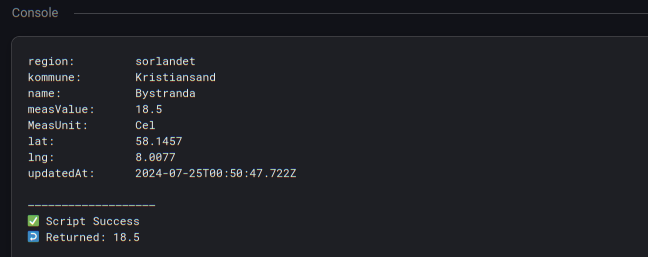

Hello Johannes,
I adjusted Robert’s code to filter on deviceID;
so after some trial & error, I found I need to use d.records.deviceID for that:

About 'struggles to connect to the URL: Maybe they log your IP and don’t want you to ‘scrape’ their site.
You can also just copy/paste the URL in a browser to see what happens (or not)
The code:
const URL = 'https://api-badetassen.eu.ngrok.io/test/get/iot/wt/data?when=last';
const response = await fetch(URL);
if (response.status !== 200) throw Error('Invalid response from website');
const data = await response.json();
const record = data.find(d => d.records.deviceID === '350916062784635');
if (! record) throw Error('Cannot find record');
//Just to show what returns what
//  oh, and \n = newline, and \t = tab
log(`region:\t\t${record.records.region}\nkommune:\t${record.records.kommune}\nname:\t\t${record.records.name}\nmeasValue:\t${record.records.measValue}\nMeasUnit:\t${record.records.measUnit}\nlat:\t\t${record.records.lat}\nlng:\t\t${record.records.lng}\nupdatedAt:\t${record.records.updatedAt}`);
// To show all returned data unfiltered
log('\nAll unfiltered data:\n',data);
return record.records.measValue;
The line log('\nAll unfiltered data:\n',data); returns this (just a snippet, while it’s huge):
