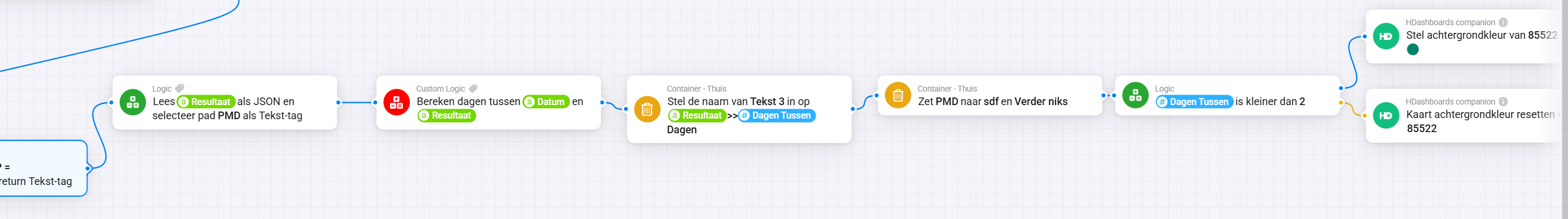

In my flow i still got the same error:

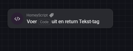

Use this Flow card:
And then copy the code from your RD4.js script to the inline code editor inside the Flow card. You can then replace the “Ophaaldagen (JSON)“ tag in the Logic card with the “Result“ tag from the script

In Hdashboard it looks like below: Only issui is still the null value, but maybe i could figure this out by myself.

Yes it’s indeed a virtual device. I could switch of the indicator for it, but then also dissapear the 02-12-2025 line, and that’s the line i would like to see.
It could maybe also comes from a flow card below. I try to replace some cards, maybe it would help
