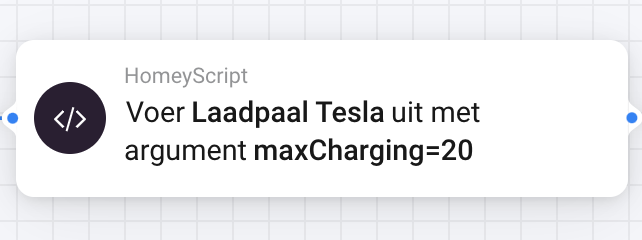

Hi @Sen-Sai ,
How could I use this setmaxcharge as a Homey script? I don’t know which argument I have to use.
This one doesn’t work:
Schermafbeelding 2022-12-02 om 15.12.16
Kind regards!
Try not to use spaces around the = , see if that works
Doesn’t do the trick unfortunately (I used now this):
Schermafbeelding 2022-12-02 om 17.21.09
Do you use that script while charging or do you have to pause first?
Big thanks for your answer.
UPDATE:
Got it, you have to use setMaxCharge=
And not maxCharging=
Now it works!!

// Make sure this script works with 1 single argument
let actionArgs = args[0].split('=');
if (typeof actionArgs[0] !== 'string') {
  throw new Error('Script must be run from a flow with a string variable');
switch (actionArgs[0]) {
  case "unlock":
    token = await connectToWallbox();
    result = await unlockWallbox(token);
    // Optional. You can leave the next 3 lines out and place them in a flow
    if (result === true) {
      say('Wallbox is ontgrendeld');
    } else say( result );
    break;
  case "lock":
    result = await lockWallbox(token);
      say('Wallbox is vergrendeld');
    break;
  case "pause":
    result = await pauseWallbox(token);
      say('Wallbox is gepauzeerd');
    break;
  case "resume":
    result = await resumeWallbox(token);
      say('Wallbox is weer an het laden');
    break;
  case "setMaxCharge":
    if (typeof actionArgs[1] === 'undefined' ) {
      break;
    result = await setMaxCharging(token, actionArgs[1]);
      say('Wallbox is ingesteld op maximaal laden van ' + actionArgs[1]);
    break;
