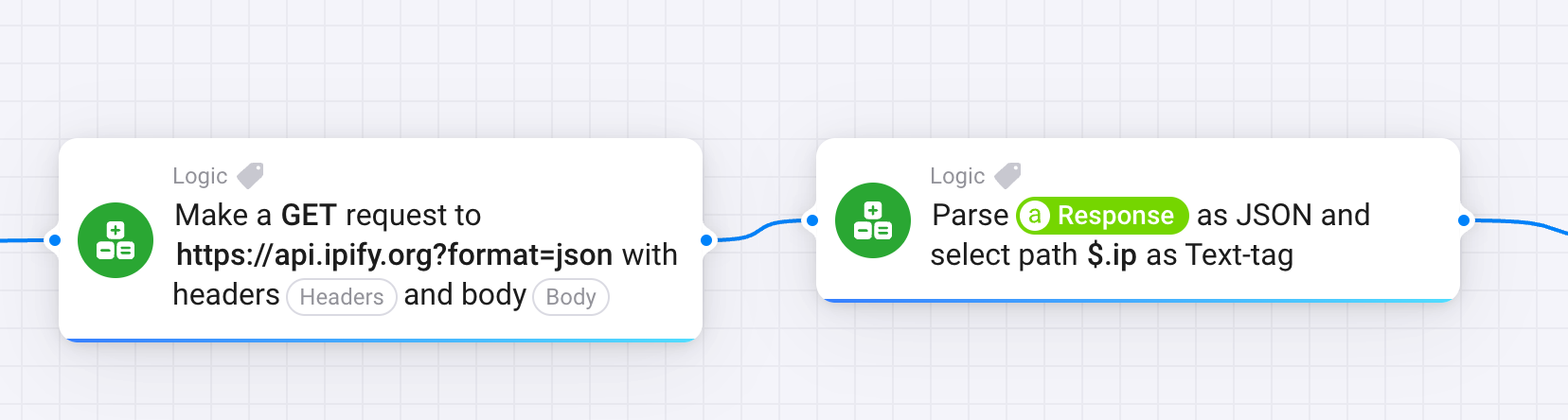

The problem with ChatGPT that it’s trying and trying and sooner or later it’s in a loop. It wants tot try previous codes.
Why not keep it simple:
(I know the topic is about Homeyscript, but sometimes it’s not the best choice)
Thank you Peter, that’s a much better option thanks.
