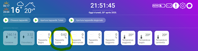

Hello, how to solve this issue?
the percentage of Blind opening is show fom 0.00% to 1.00%
In the picture the blind is at 62%, not at 0.62%

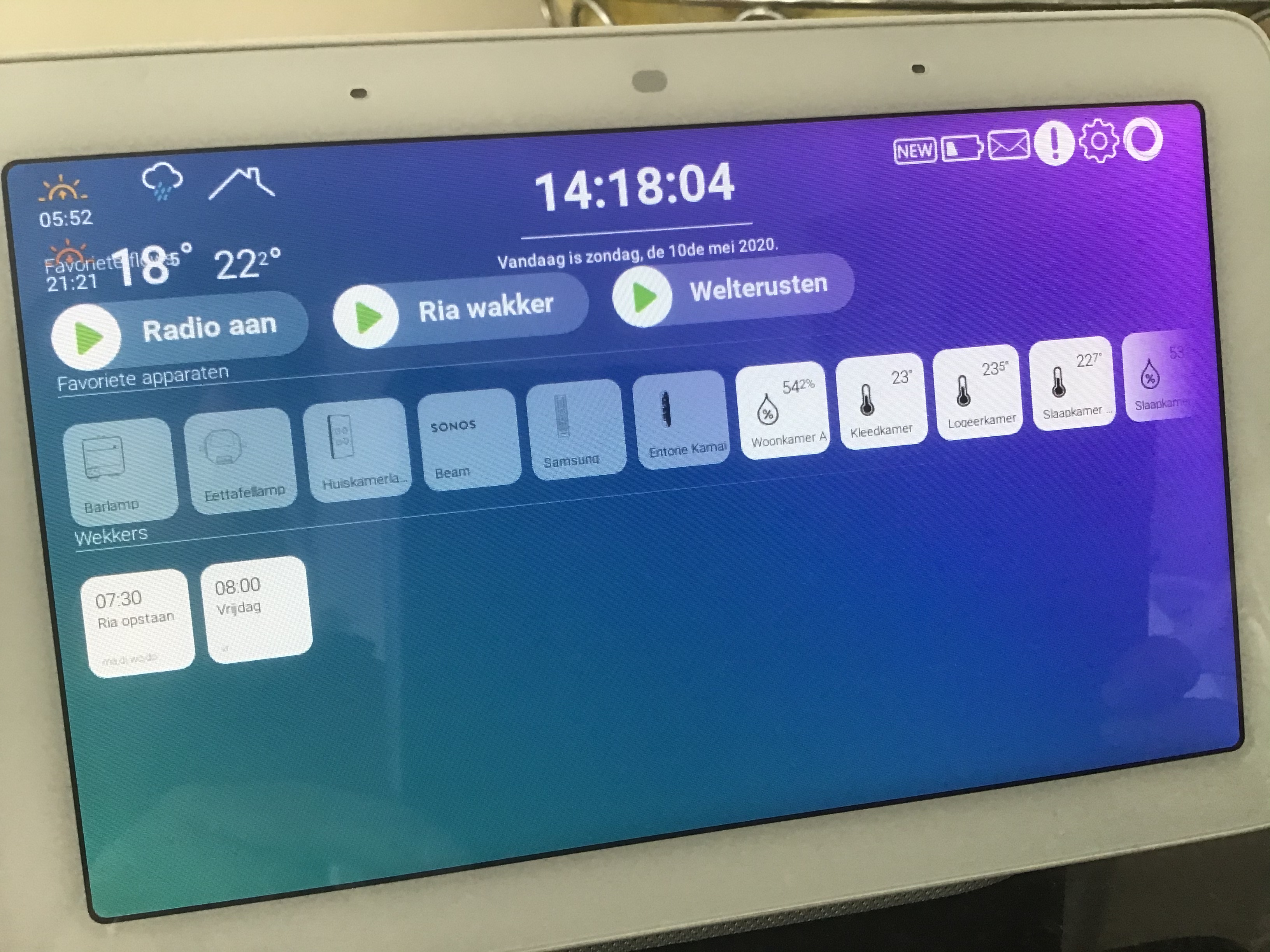

Using Homeydash on a Google Hub for quite some time now and always worked great.
Now it looks like the Google Hub got a firmware upgrade and Homeydash stops after 10 minutes and the Hub is displaying the Clock again.
This means i have to start the casting of Homeydash every 10 minutes again to keep it displaying the dashboard.
I have another Google Hub in my bedroom that seems to still be running on older firmware and here Homeydash is still working fine.
Anyone had the same issue with the new Google Hub version?
Same here yes, not funny!
Same here. Google introduced a 10 minute timeout. Hoping this will be reverted soon. Otherwise i will replace it with a Pi screen or something else.

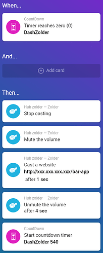

For now i made a timer with the countdown app.
Where u start the casting, also start a timer (make sure u create the timer first in the app settings) in the same flow for about 9 minutes:
When timer ends stop casting, start casting again (after one second delay) and start the timer again:
When u stop casting, also stop the timer:

Why not use the every 9/10minutes flow card instead of the timer?
Also possible. U know any benefits for that?
I don’t think any big advantages. I just like to keep it native as much as possible and that way you won’t have to use an extra timer
