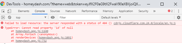

Indeed I see following errors:
Errors
I can’t see the reason of this error…
It looks like Homey/Athom-API is returning a device list with invalid content. The device object in the list is “null”/not present and the schript can’t read its attributes (id).

You can try the following steps:
  • clear the cache/cookies in chrome and the domain settings for homeydash.com
  • remove the first device in your favorite list in Hiomey app to check if it’s depending on the device itself

Thanks Ronny that works!
First device was a Brell roller blind which I removed now.
