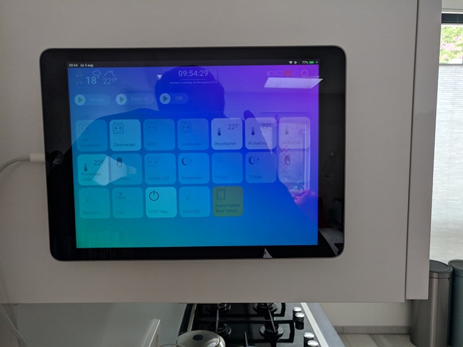

I have followed the steps and it seems to work fine. Can you tell what you have used to set the background to black? Cause the background is not dimming :face_with_monocle:
You need to set a background (URL) in the settings. If it’s a black (or dark) background than your all set.

i use this background url: https://upload.wikimedia.org/wikipedia/de/4/4b/Black.JPG
By having a virtual device like explained with dimming functionality (and dimming only) and call it Homeydash-### (where you can choose ### freely).
Then you can set the dimming level in a flow where the trigger is the motion sensor.
