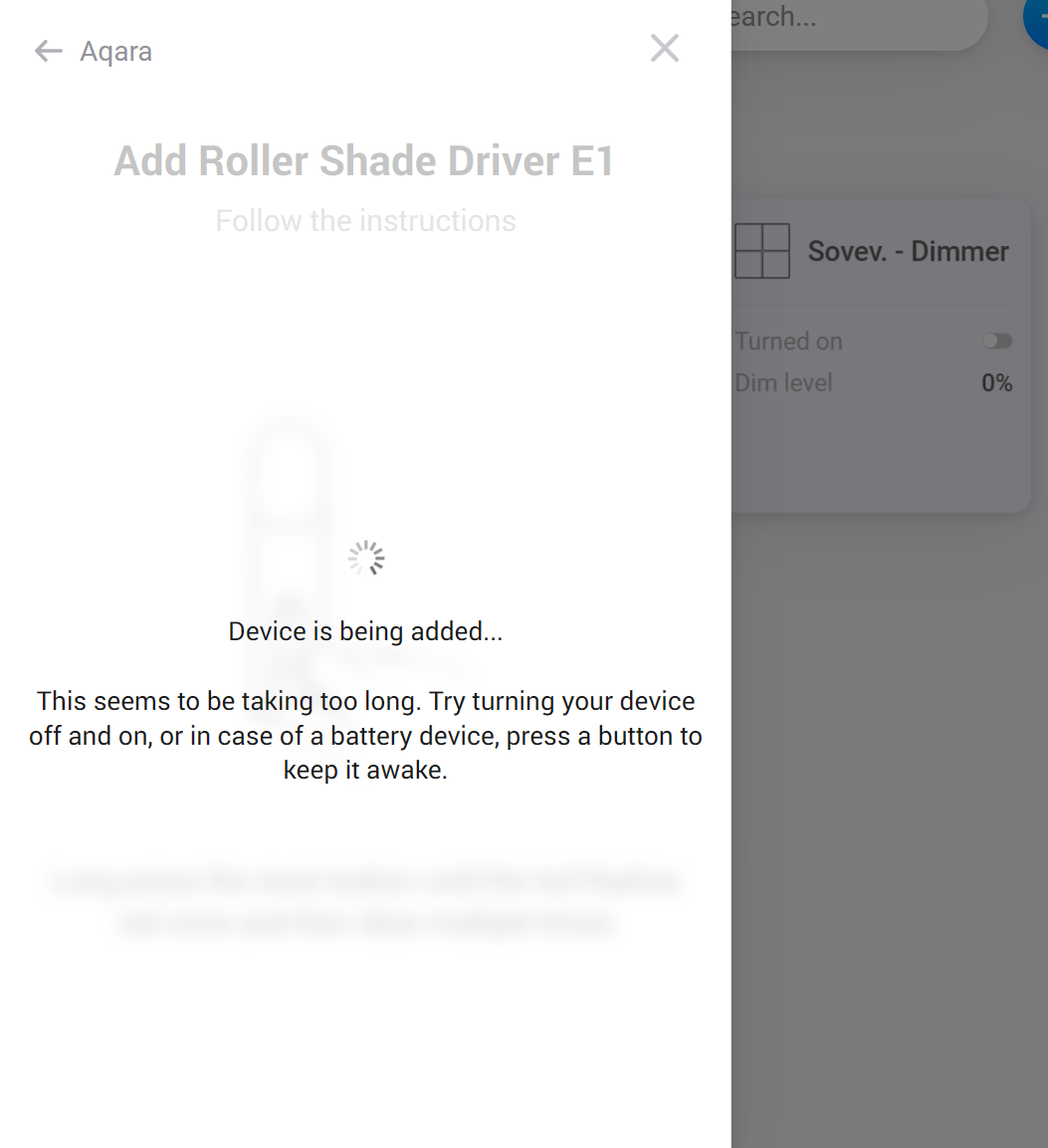

I also have big zigbee problem on 10.3.5, can not add more, can not reconnect / repair and very slow. Anymore with some ideas to fix, while we are waiting at Athom ??

HUE is working again, Aqara roller and door sensor not. Repair and remove / add does not help
