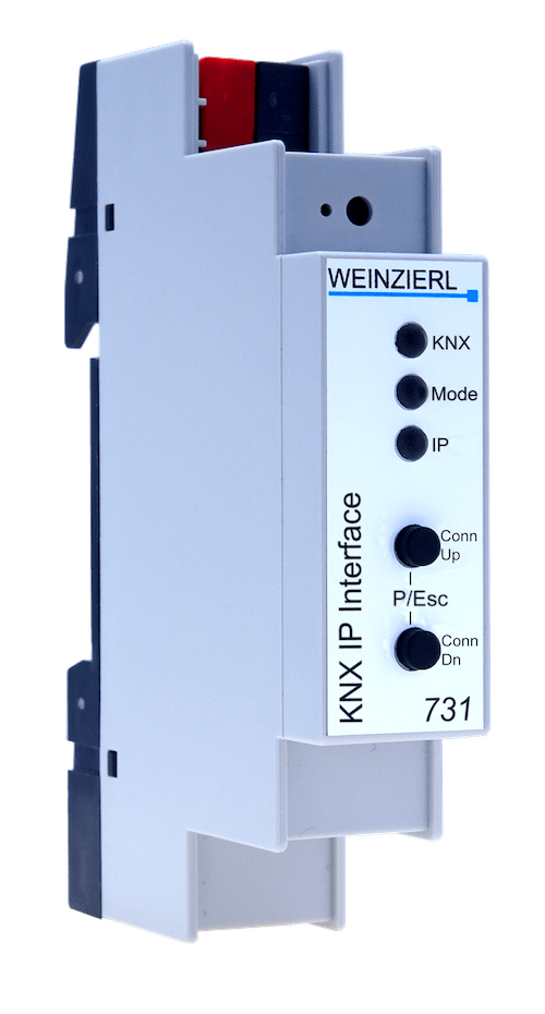

I recently purchased a Homey Pro and the KNX Weinzierl 731 IP interface.
I installed it on the KNX bus and the LAN to my switich. Technically I can ping it but due to time constraints I need to plan next steps. I keep you posted.
