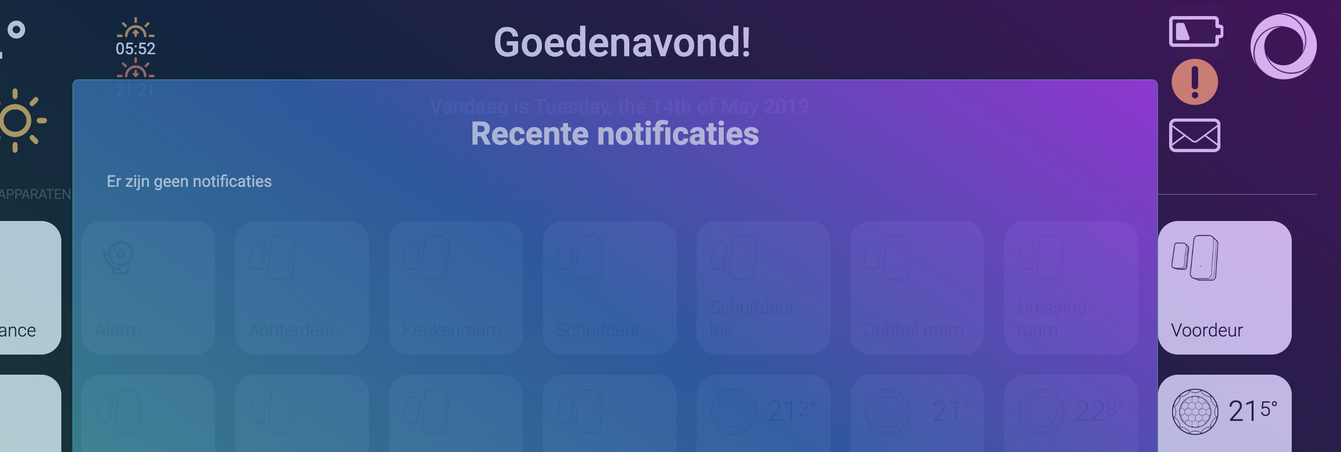

Homey.ink on a tablet/desktop
Works, thanks!

Date is also localised now:
