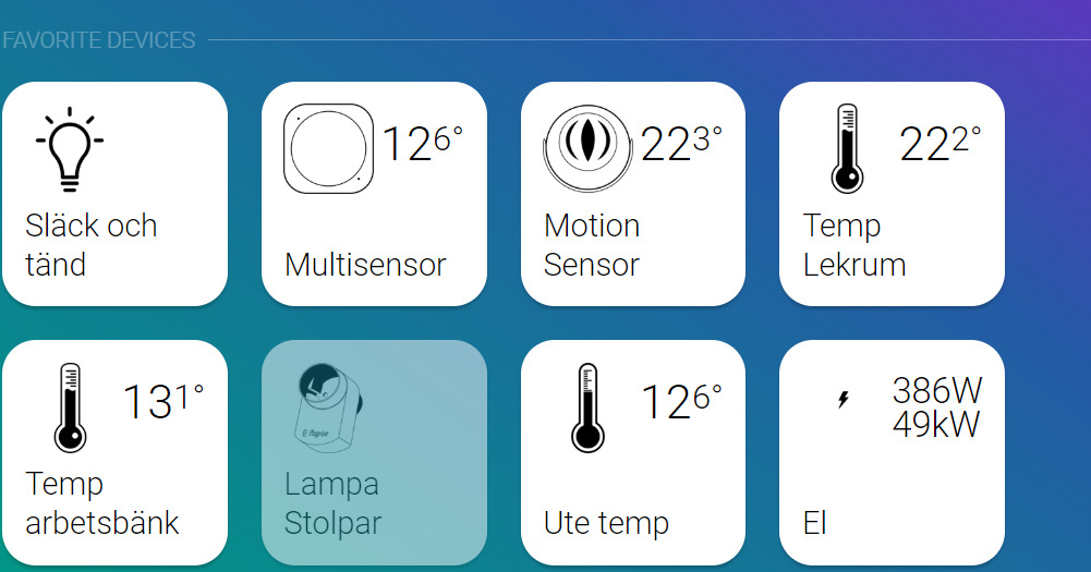

I got temperature, humidity and lux presented in one “device tile”.
I also have power in W and kWh presented on “device tile”
But as it works onw its only displaying the latest sensor in the script, lux for me right now.
I would like it to toggle either for X seconds or by pressing the “device tile”

To display all values at the same time, i believe you have to adjust the code so every value gets it’s own line space in the tile. Just copying the device capability code for every capability will probably indeed show all values but all in the same space and thus shows the last pushed value.
But since i’m no expert, this is just an assumption after logical thinking…
But it seems you have managed to do this with the P1 tile, so can you share that code (plzplzplzplz)?

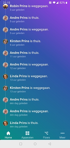

I’m using your version, but tried Ruud’s version as well. Same thing. I downloaded your version this morning again to make sure. Check this screenshot I just created I had notifications this morning. The error said something with the CreateDate. I’ll download your latest version in a minute and test again. Thanks!

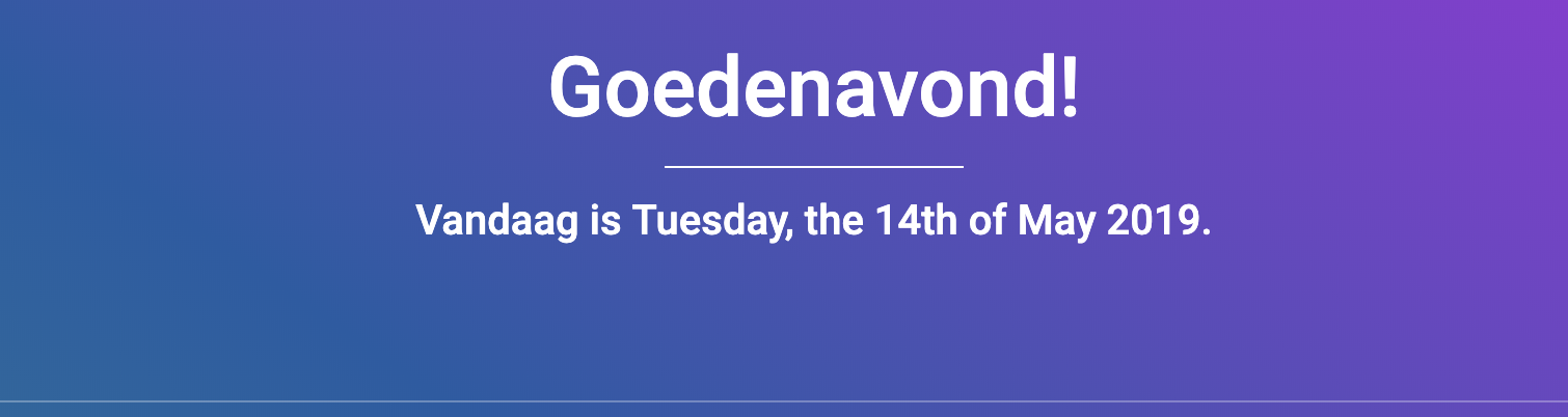

Works for me, thanks for the NL version, is it also possible to translate the date?
Also in the notification window we have some English left in the NL version
Thanks!
Yes, the date is on the todo list, the ‘There are no notifications’ is one I missed, will add it.
