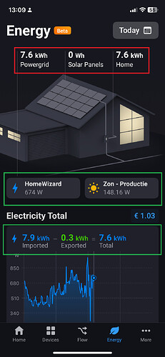

@Robin Thanks! That removed the double Solar entry underneath the house, see my post with images somewhere above. But still no correct energy data above the house (both are Grid minus Solar) and no Solar total which remains on 0 Wh although the chart populates correctly.
Seems these two numbers are not from the same source…
Also, these numbers (and Solar Panels) never change when the app is open, I have to (force)close the app and open it again to get a new reading.
(Notice this on iPhone and iPad)
What app/driver are you using for the solar panels? It looks like it doesn’t have the meter_power capability (you could check this at Homey Developer Tools).

@Robin Yes it does. As stated above, it is a Shelly EM.
