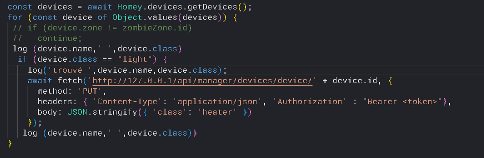

I have exactly the same issue : change the class of some devices from ‘light’ to ‘heater’.
But, I was not successful using your code !!
Could you give me more detailed process ?
Regards
I try this code, it seems working, but the new class does not remain after the end of the code …
And the result :
I’ve tried your code, and there is no error , but no result, the class is not modified :
and the result :
Could you help me ?
REgards
You have to replace this with your actual bearer token. There are a few ways to do this, not sure which one is the best one: homey get bearer token - Google Search
I understand, now. It is so obvious …
I look for this token, but I was not successful …
I still need some extra help !!
device is not updated dynamically, after you make the call to fetch() you need to reload the script to see if the class has changed (or go to this page).
Finally, I got the bearer token by the mean of Robert Klepp code.
And I was succesful changing the class of devices from light to Heater.
Thanks a lot for your help
