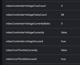

So please check Homey’s CPU for Undervoltage Alarms

Where can I find this low-voltage alarm function? Or where can I view this data?
In the System section of the Homey Developer Tools page.
