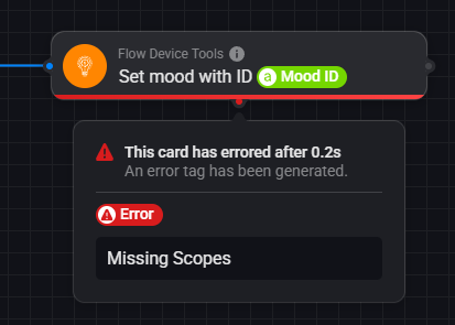

Can I asume that triggering moods has the same restriction?
(20.9s is caused by the debugger)

UPDATE
I thought I found the solution, be I got the same error (Missing Scopes)…

I don’t think Athom will allow this, but looks like you’ll have to ask Athom to add your app to the web api’s scope list of moods.
I don’t understand why the Homey Web API would block this. A mood exposes less functionality than devices, yet with "homey:manager:api" permission I can control all devices.
The funny thing is… I can read the properties (the configuration) of the mood and I can control the capabilities of the devices. That means I can actually set a mood by applying (for each device in the mood) each property in the mood to the capability in the device. So why don’t they save me the trouble and just allow setting moods when you have "homey:manager:api" permission? They could also add a new permission "homey:manager:moods" that explicitly allows setting moods.
For my setup at home, I can easily solve this by creating a HomeyScript “Set mood by ID”, but I would have loved to have this card in my app and offer it to the rest of the community too.
@Caseda
Thanks for responding… not the answer I was hoping for, but much appreciated.
How do I proceed? Can you point me in the right direction?
↳ Do I open a support ticket for this?
↳ Is there a topic for feature requests?
↳ Is there a mailbox I can write to?
Support ticket is your only way.
There are several things behind the scope wall, devices is one of the few that isn’t.
still waiting for dashboard scope support for HomeyScript (yes even HomeyScript doesn’t have all scopes)
