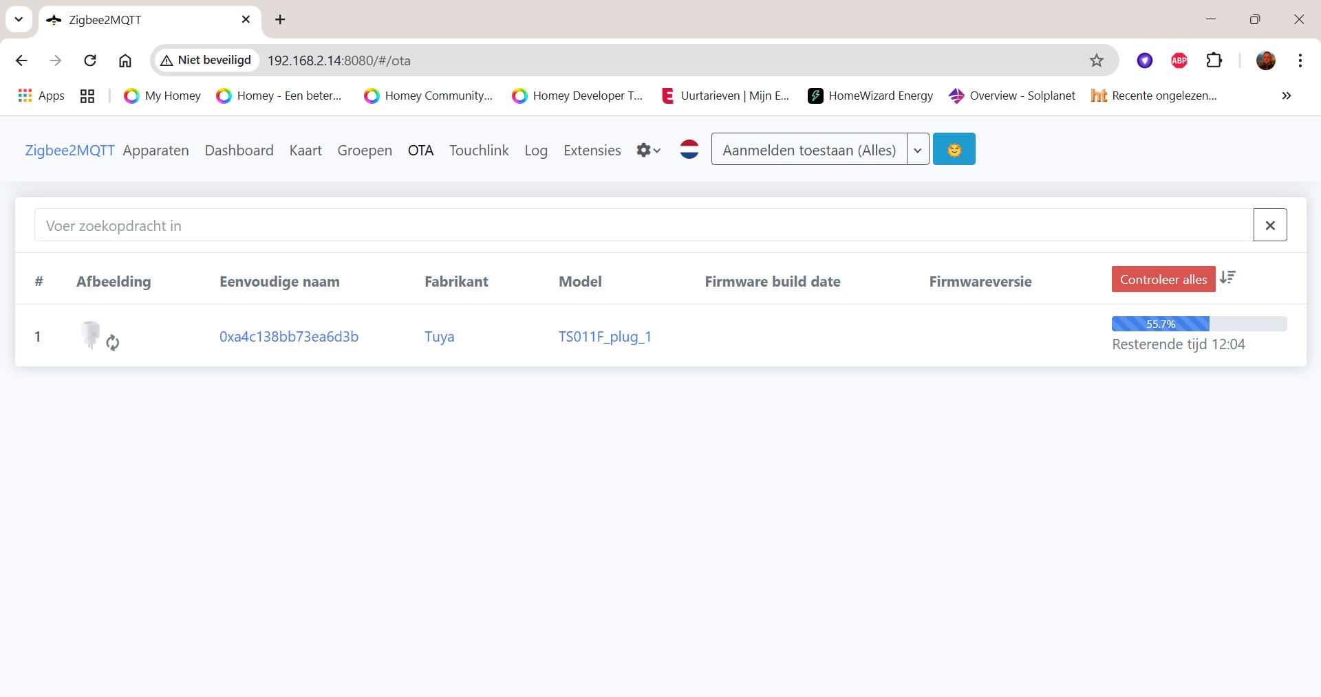

ZigbeeMQTT with Frontend on Windows 11 is working with Mosquitto Broker, Zigbee2MQTT and the Sonoff USB Dongle E
First Tuya/Nous device is updating at this very moment. When finished, will compare them within Homey to see and check firmware.
Update in progress

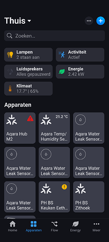

Aqara still a nice screen… lol
But, after adding a sensor…
and
Also checking next days what is going on…
edit: for the moment only 1 THS connected through Aqara M2 and Matter

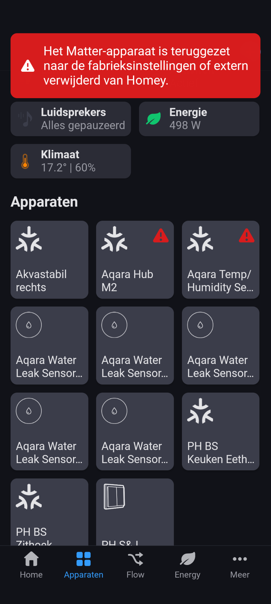

Today some more experiencing…
Aqara → add a device
As soon as I added a device, the previous is kicked out.
Than Philips HUE adding a device
and exact the same behaviour
and the new added device is also not available
After that removed both Matter connections for Aqara and Philips HUE. Then reconnected them both.
All working, till I add something… So it is not working proper as it should for the moment.
