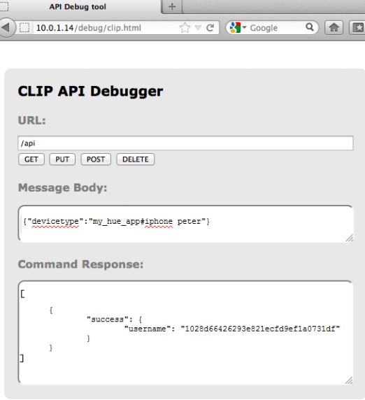

In the debug tool fill in the following
URL: /api
Message Body: {“devicetype”:“xxx”}
Now hit the big button on the top of the Hue bridge
Within a few second send this command by pressing "POST"in the clip API tool.
The response will contain your “username” which you need in the next step.
