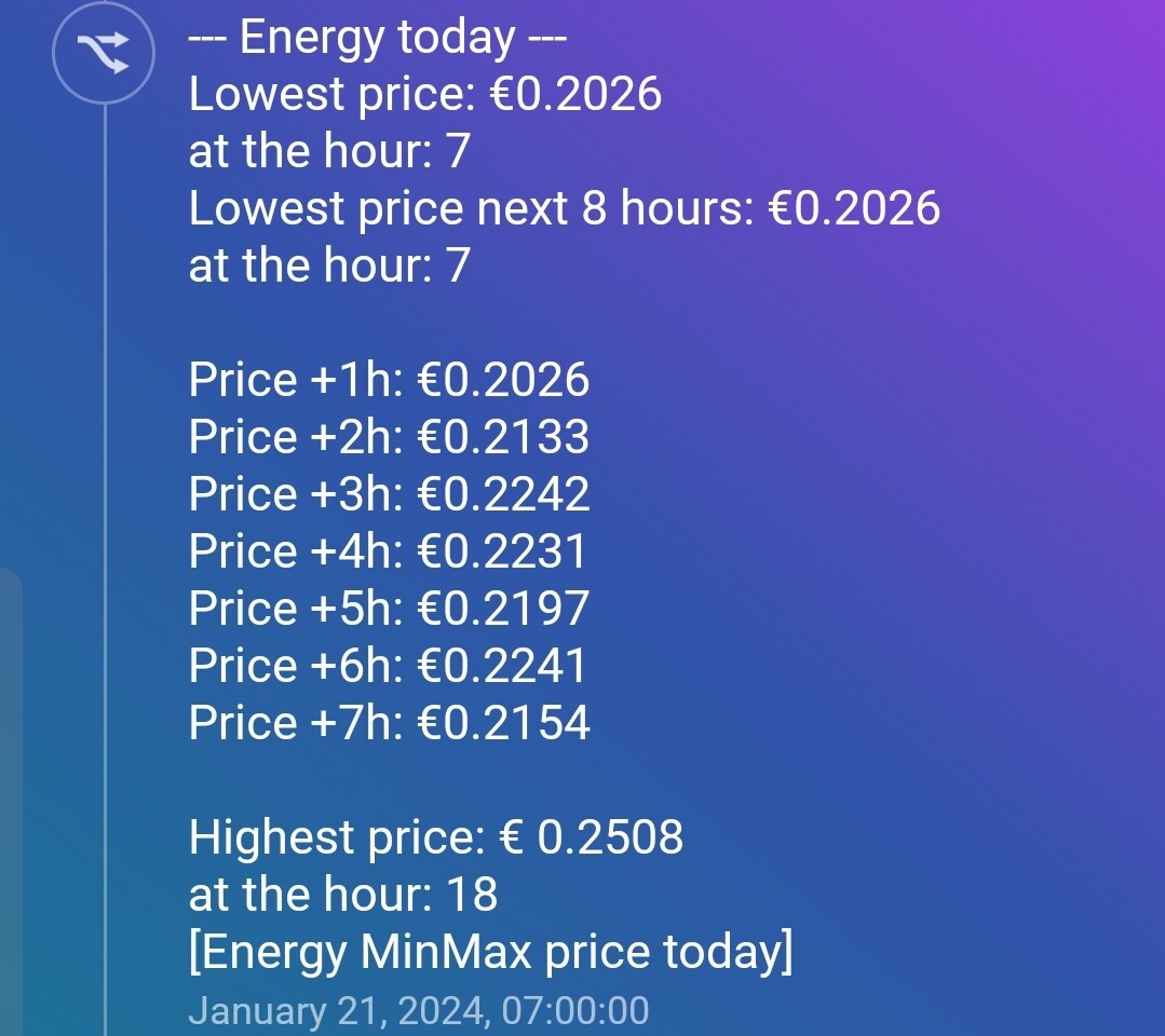

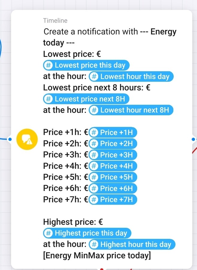

It can do this f.i.
Result:

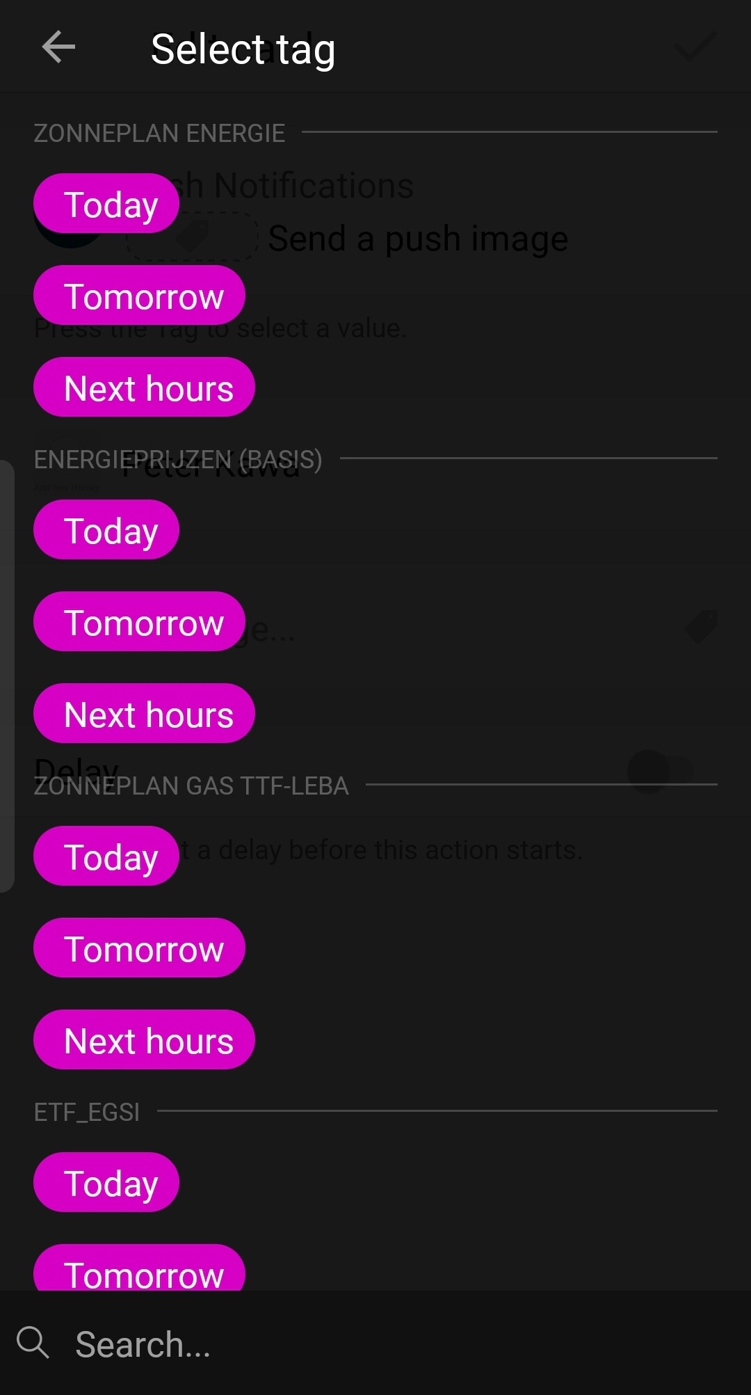

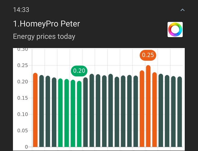

It also has the prices available as graph picture (in a camera capability), which you can send as image.
Pick the cam tag you’d like:
Send a push message with image results in:

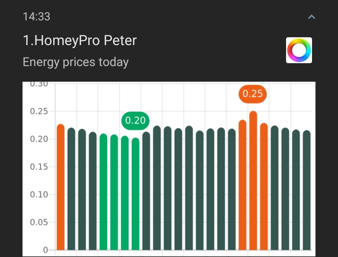

Push message:
So, with this price graph of today, the flow should trigger at 5 or 6 o’clock I presume.
