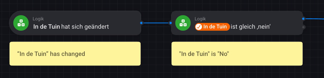

1 of my blinds should stay open when we are in the garden. I created a variable “in de tuin” (yes/no type). Will this work?
The issue is, how can I start another flow when the variable flips to no again (on a button press of a remotec scene master). I would like to turn off all the garden lights and close the blind that stayed open…
Is this possible with a yes/no variable?

Yes, another flow can be started if the Yes/No variable “In de tuin” is changed to No. Like this:

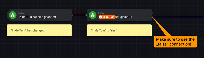

Or just flip the logic condition flow card:

Hi Dirk,
Awesome! Implemented and works great!
Thanks for the fast reply and the clear instructions :slight_smile:
