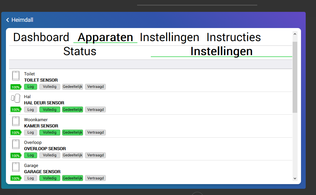

The error in the log breaks my head, I can’t really find what causes it, it doesn’t say which capability is invalid or what line caused the error. Not sure if it causes the Surveillance Mode to be not ready or it not being ready causes it but I think they’re linked.
Surprisingly the zones are now shows for both the Status and Instellingen pages.

i believe this is what you wanted to see.

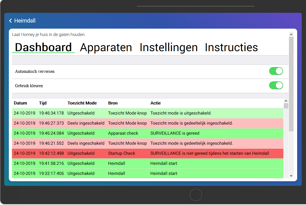

We played with the settings, and if we turn off the speach settings, it’s possible to disable the setting. So this part is solved. Only the logs of the sensors when not armed remaines( blue lines). When armed it is registered in the log( light red).
Yes, that’s the settings, thanks.
They do look ok, I wonder why Delays showed up as undefined earlier, somehow the settings couldn’t be read at that point in time and may have caused the problems with not being able to change settings. I think that’s an isolated problem and seems to be not appearing anymore.

So, the remaining problem, not logging for devices that should log… I’m gonna dive into that part of the code again, I must be overlooking something…
I’ll keep you posted on progress!
(It could help if you could post a part of the log here when you run Heimdall from the cli and activate a sensor that should log, basically the part you posted earlier starting with the line of dashes just before stateChange)
