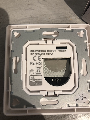

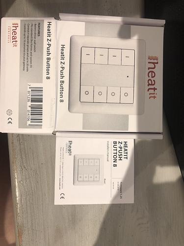

Here is a picture of the backside of the device, and in the next post a picture of the box / manual that came with it.
(can only post 1 image per post since im a new user…)
That’s strange…
The box and manual show the Heatit branding, while the device itself is Sunricher branded…
which corresponds to the manufacturer ID (816). Really strange.

Quick update, went to the store and opened a few of the Z-Push boxes and all where Sunricher branded.
We then called Thermo-floor and they said that they where now also using the Sunricher brand in the new boxes they are sending out, but they would make a note of it and said that they will ask for the firmware to be changed so it identifies as a heatit brand.
So that will probably take some time…
