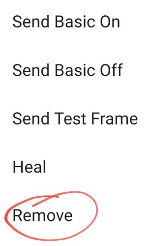

Go to https://developer.athom.com/tools/zwave and remove your device. Make sure it does not have any power (unplug your power cables) and wait for a few minutes. Then use the remove option from within the developer site.
