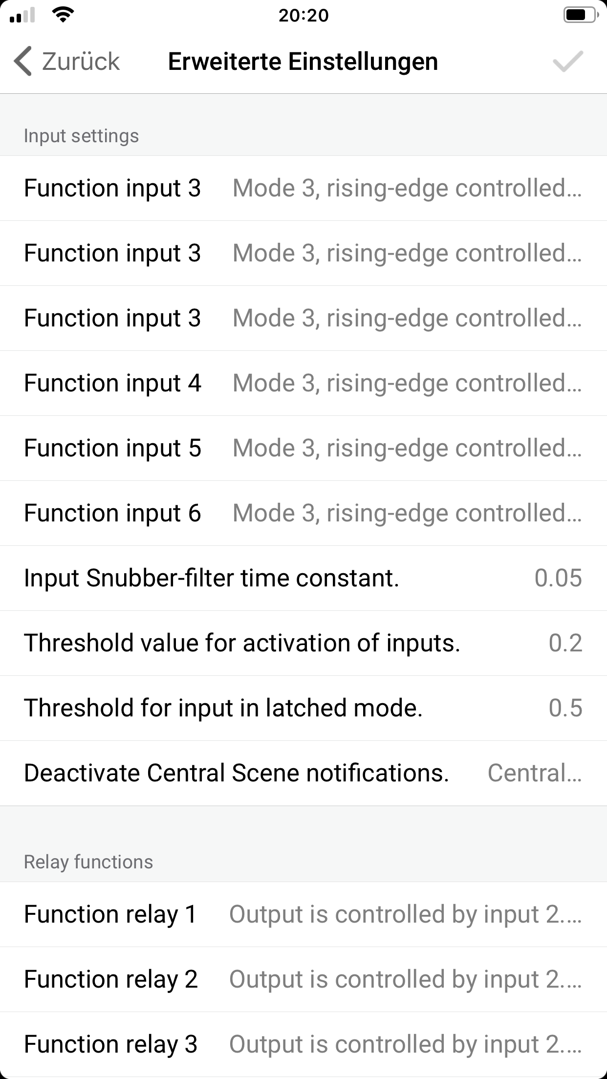

Has somebody tried use one of 6 Inputs on HeatIt DIN 616 Module?
I can control all 6 output Relais… there are also setup options for the inputs but no inputs aviable…
