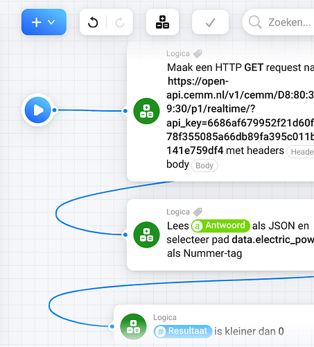

I created an advanced flow that connects (get request) to an external API (Cemm/Cedel) to collect my solar production. If solar production exceeds target value, I start charging my EV.
Flow works flawless. However, quite often the external API returns not a response, but a promise… If that happens, the flow generates an error… Is there an advanced flow workaround that anybody knows of?
