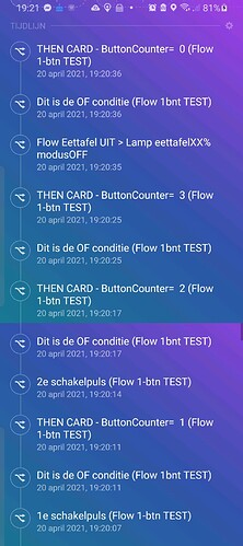

Timeline “check” messages:
And it did happen :wink: :
