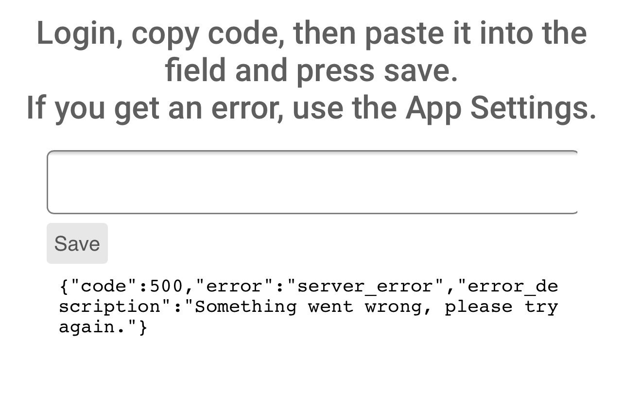

In HOOP in the settings you can add javascript functions and use that in the Flow Variables cards.
I log in to the Athom devolper setting and copy/paste the code into the app. When I go back to the app and press “configure app” I get an error :
I want to install the Homey Elevator but I get also an error :
I’ve read the above and tried again but no luck? Anyone can help?
Install 1.2.3 when its in the store and use the settings, the issue for iOS has been resolved.
Okay thanks, I will install it when it’s in the store
v 1.2.3. is in the store now.
I’ve installed version 1.2.3 and still the same error when I tried to install the Homey Elevator device. The error when I go to the configure app page is gone. Thanks for that.
Indeed, the Elevator device will give an error on some phones (iOS) and there is nothing i can do about that. Thats why i have the backup settings-elevation which again works correctly as backup for some phone’s.

Hey Arie, I got this error this evening when searching for trigger card devices, screenshot:
I realized I enabled 2FA the other day, and did not logout everywhere I could think of. The Homey app on my Android is keeping the logoff button a secret to me, so I did not logoff from the app.
So I logged on to various Athom & Homey related sites with my H. account and 2FA codes, also at my.homey.app
But no difference whith this error.
At the Homey app on Android the trigger devices are still presented and selectable.
Any ideas? No hurry (for me)
Trying to create an homey elevator device again? Or use the settings to re-elevate.
Update2:
  • 1st used the settings to re-elevate. No effect
  • 2nd re created an homey elevator device. No effect
    • NOTE: While starting with building flows it seems to work fine, when reaching flows of this size, it gets worse (this flow doesn’t do what I expect it to do yet):
  • The Homey memory check page timed out with an Unknown Error, but after 10 retries, now it works.
  • Oww, the H.o.o.p. app uses 45.5MB. Not your fault my Homey is choking because of the extra 20-30MB of ram usage, it is packed to the max so that’s solely my problem.
    • I gave the H.o.o.p. app a restart command, but it timed out after 30 secs.
      Now I, reluctantly, restarted Homey and call it quits for today.
  • After rebooting Homey, H.o.o.p. app is using 18,1MB, and Homey 106.4MB… it shrunk with 110MB’s…
    So all in all it’s a combination of a growing app, and growing Homey ram usage.
