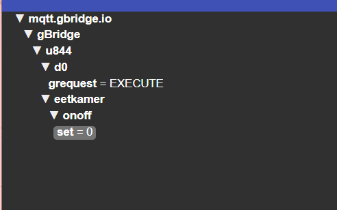

When I try to turn on a light in Home, I see d0/grequest gets set to EXECUTE but nothing happens
When I do a Broadcast in Hub, I see nothing changing in Explorer. Before you could see all the topics getting updated. Also no more popup saying broadcast was successful…

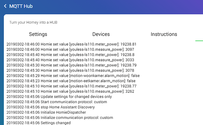

When I use the wallswitch I see this being added in the Hub logs so Hub sees it happening
When I use GHome to turn on a light, I see it changing in MQTT Explorer (but light doesn’t work) so it communicates with gBridge.

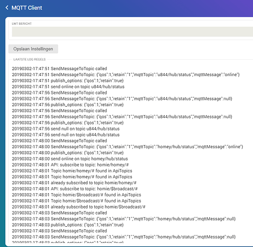

Check Homey MQTT Client log is showing a successful connection.
Client:
Hub:
So, what am I doing wrong? :smile:

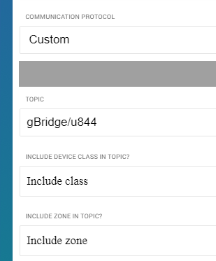

I can’t see your Homey Hub settings - it’s right side truncated.
Do you have ‘normalize’, ‘Include zone’ or ‘Include Class’ switched on ? (should be OFF)
Do you have ‘Broadcast device state changes’ on ? (should be ON)
If you are only using gBridge I recommend not using ‘Custom’ as it require more configuration and allows you to break things much more easily, (especially if you include zones and/or class)

Ok, changed it to Homie instead of Custom.
These are all the settings:
Not much to see except for the topic :slight_smile:

There seems to be no connection from Homey to gBridge so some config is wrong poss in MQTT Client.
